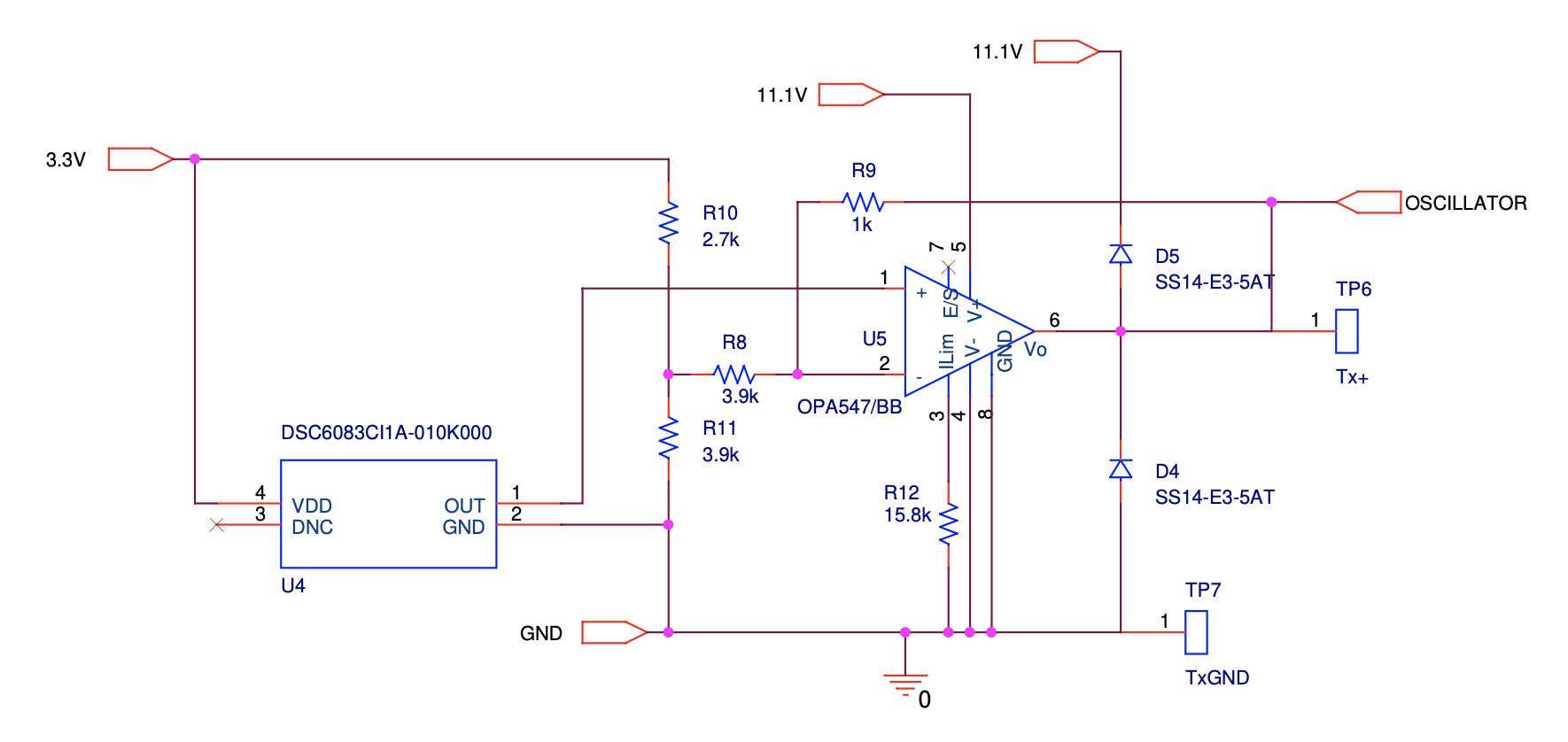

    I am designing a metal-detector for a senior project in electrical engineering. For the coil, I went with the VLF DD design in the Inside the Metal Detector book. We have an oscillator circuit that delivers 500mA at 10kHz (square wave) to the coil. The detection circuit amplifies the receive signal to a max of 3.3V. When we test the coils through an o-scope with metal, we are getting noticeable results with large pieces of metal about 10-18 cm from the coils, and anything beyond that is unnoticeable.
    We are unsure as to what factors effect detection range and how we can possibly modify our coils or circuit to improve the detection range. The coils will be easier to modify since the circuit is a PCB and major changes to it are make-shift since we can't change the layout of the PCB any more. Any help is appreciated.

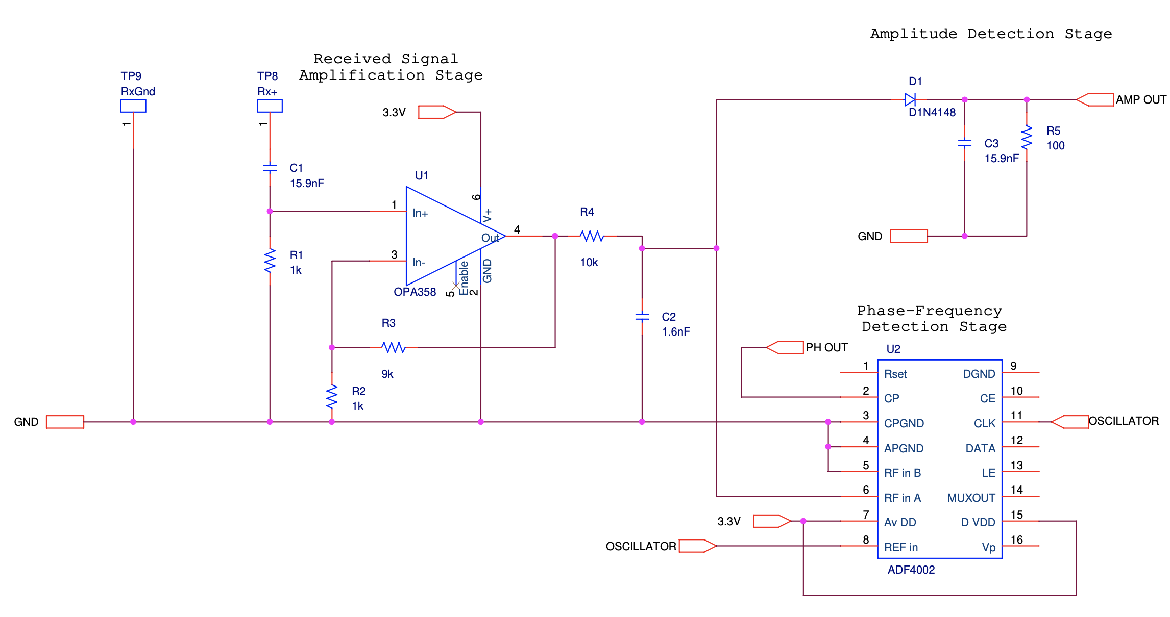

          Here are the relevant schematics for the oscillator and detection circuits. Our signal is processed by an MSP430F5507 MCU. I will need to see if it can detect changes in a signal that are that small.
            You only have a pre-amp gain of 10 , less in practice as your LPF on it's output has an fc = 10 kHz, so you're attenuating some of the fundamental as well as the harmonics.
            Increasing gain to 100 up to 500 would be a good start. Do this with a second amplifier, don't have one high-gain stage. If your coil null output is below 5 mV peak-peak, your ADC should cope with that.
              Thank you. We will have to find a creative way to implement a second amplification stage since we can't make any more changes to the PCB layout. Do you think its possible to make this change by soldering a new op amp using a technique similar to one here? https://www.circuitrework.com/guides/6-3.html

                Another way is to build a board with the added circuits that then plugs into the pre-amp socket picking up power, input and output.
                There are some two stage pre-amps in this Geotech forum that plug into the original single stage pre-amp socket.
