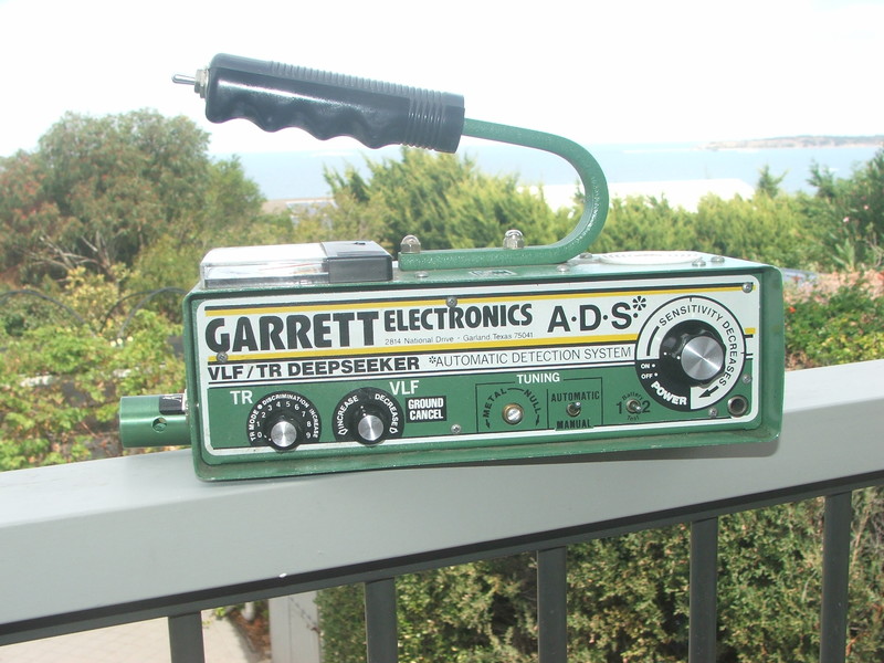

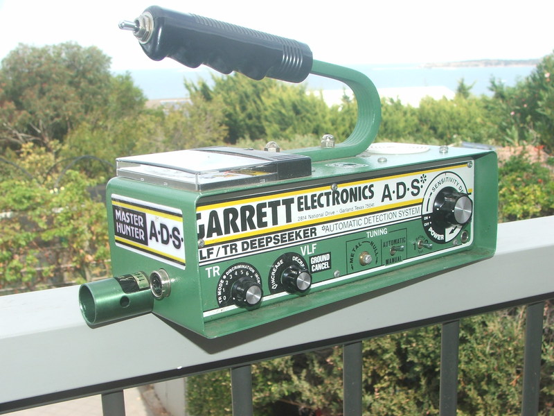

    I was recently given this Garrett VLF/TR Deepseeker to to see if I could get it working but unfortunately all the owner had was the control box ? no coil or shaft.
    A search of this forum soon turned up a circuit diagram which seemed to be a close match (thanks!) and before long I had it emitting a continuous beep when switched on, so I am hopeful that it may now work. The problem is that I do not have a suitable coil to test it with. I searched the forum again for coil details but could find nothing other than mention of a co-planar coil. Further searching on the web did not come up with any useful information so I am appealing here for any details and help. I am quite prepared to have a go at building a coil if I can get some info to get started as I have built quite an assortment of PI machines and see this as a good learning opportunity with this type of detector.
    As can be seen from the photos it is a Garrett ADS VLF/TR Deepseeker ?Master Hunter?
    Your best bet is to find a compatible coil. Keith Wills (http://brokendetector.com) has a bunch of old coils, or eBay.
      Thanks Carl. I have been watching ebay for a while but without coil specs I don't know what would be suitable. Also the high cost of freight from the US to Aus is a bit of a deal breaker for a detector of this age. I'm just treating it as a learning exercise and not prepared to spend too much on it at this stage .

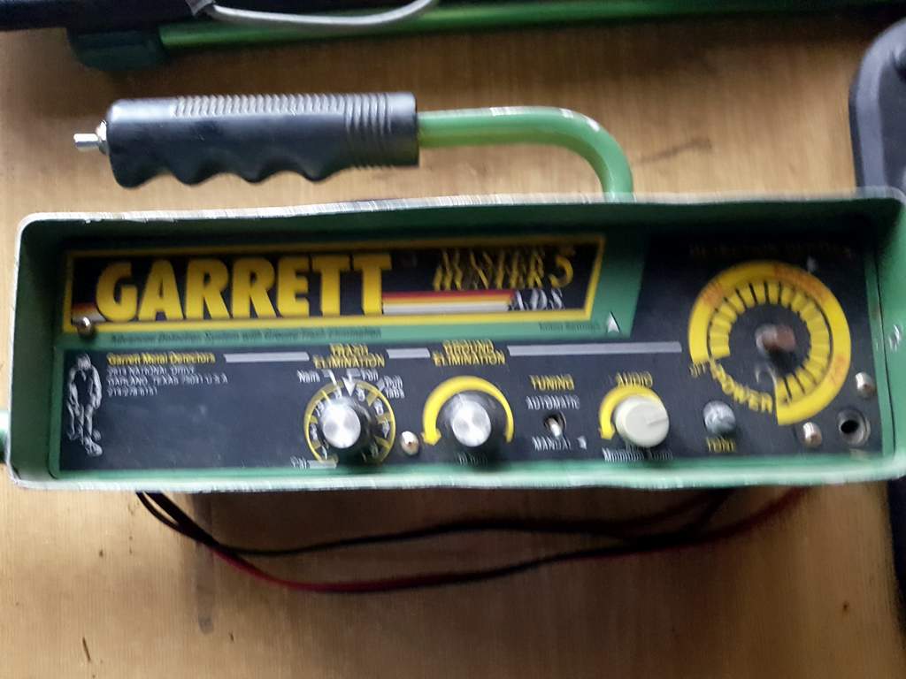

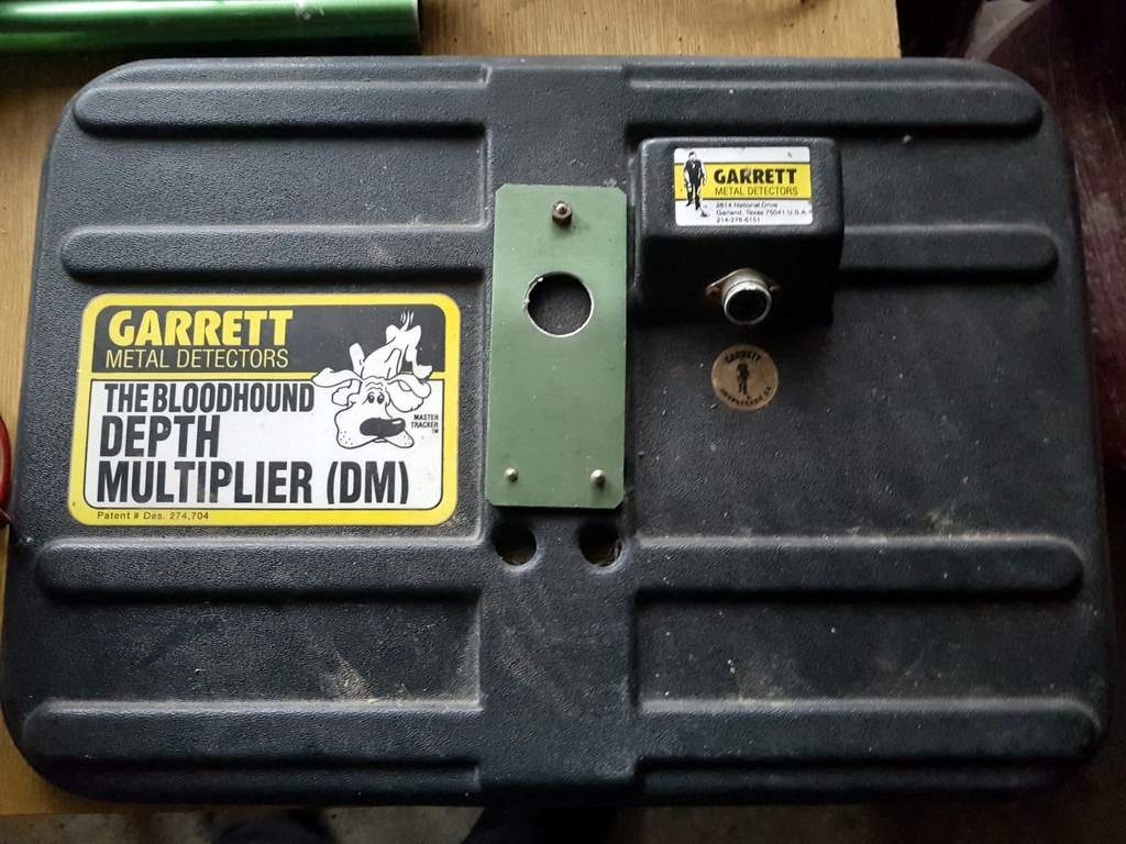

        Few weeks ago i decided to clean and rearrange the "scrapyard" in my addict.
        Surprisingly and strangely enoguh; i discovered several ruined detectors that i totally forgot there!
        Winter, annoyance, so i started to reverse ee this one:

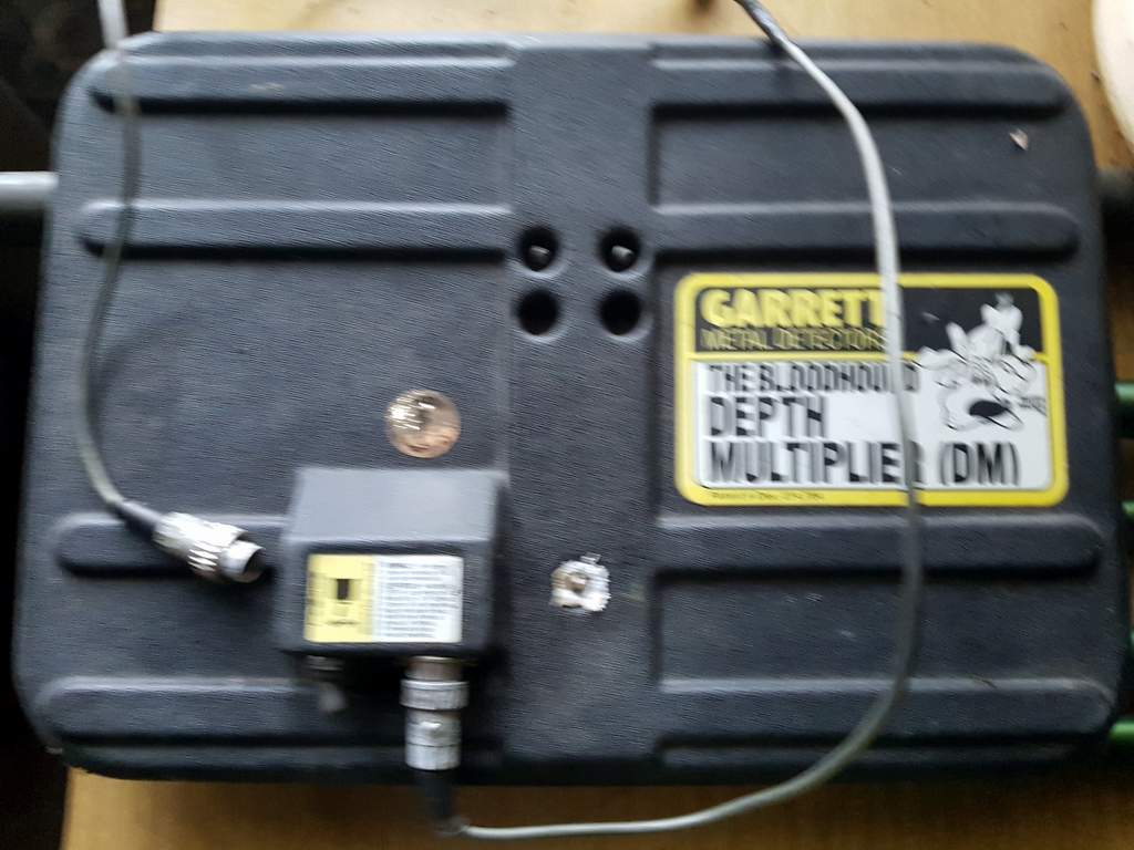

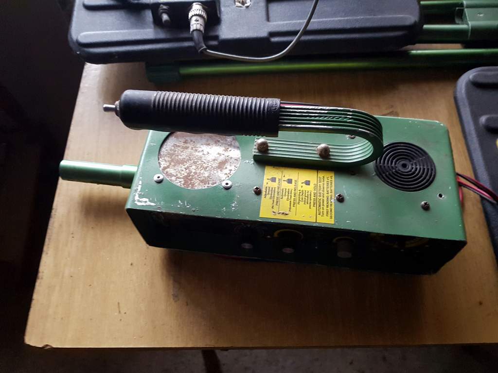

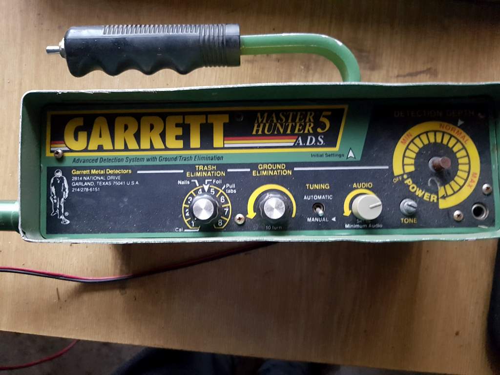

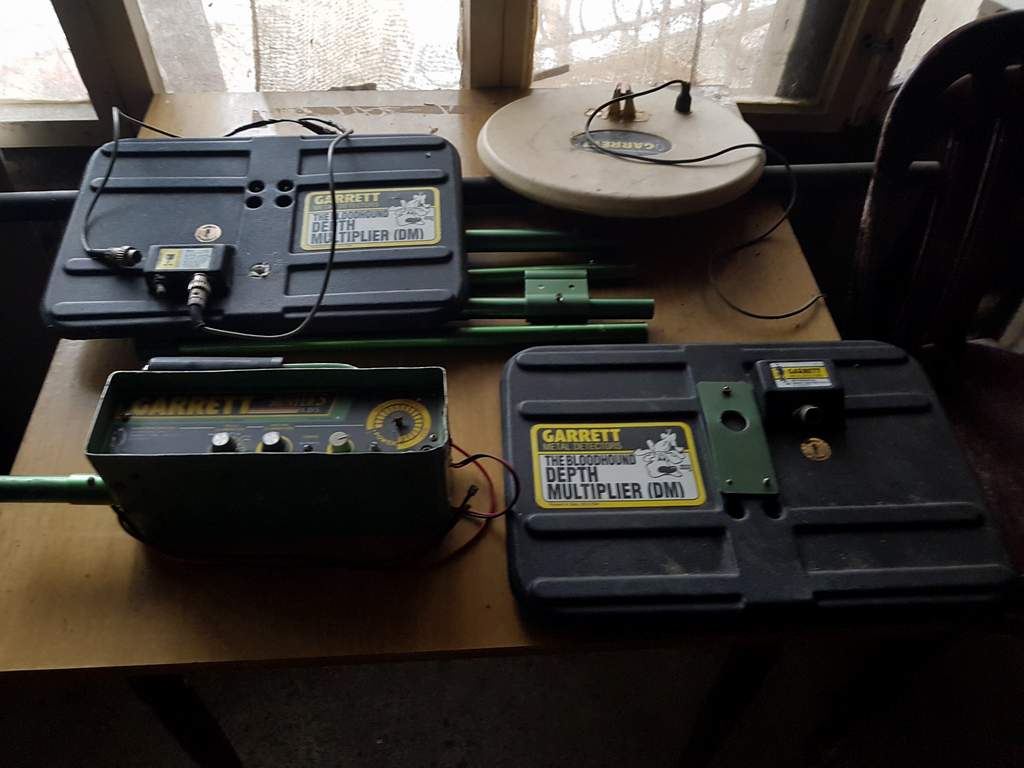

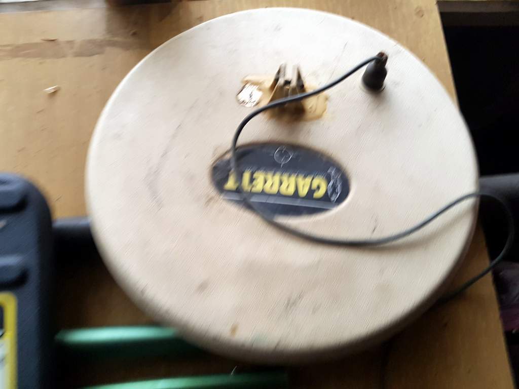

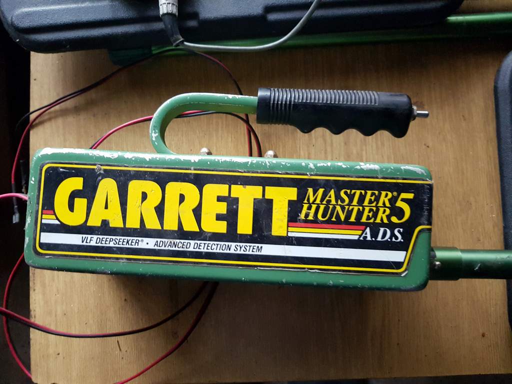

        So far i did this:
          Neither one of the coils have connector, all cut off and God knows where those are.
          I took round coil and tried to measure it, it has 4 wires and shielding.
          So:
          Red-Black = 6.3ohms/1.32mH
          White-Green = can't measure, probably some component in series ... or broken.
          Haven't tried yet to measure those "2box" coils. Will do these days.
          Although i think it would be with obstacles too, there are some switches on those coils,
          probably some "electronics" inside and probably will prevent accurate readings.
          I don't feel kinda good about cutting and opening those coils... at least not yet.

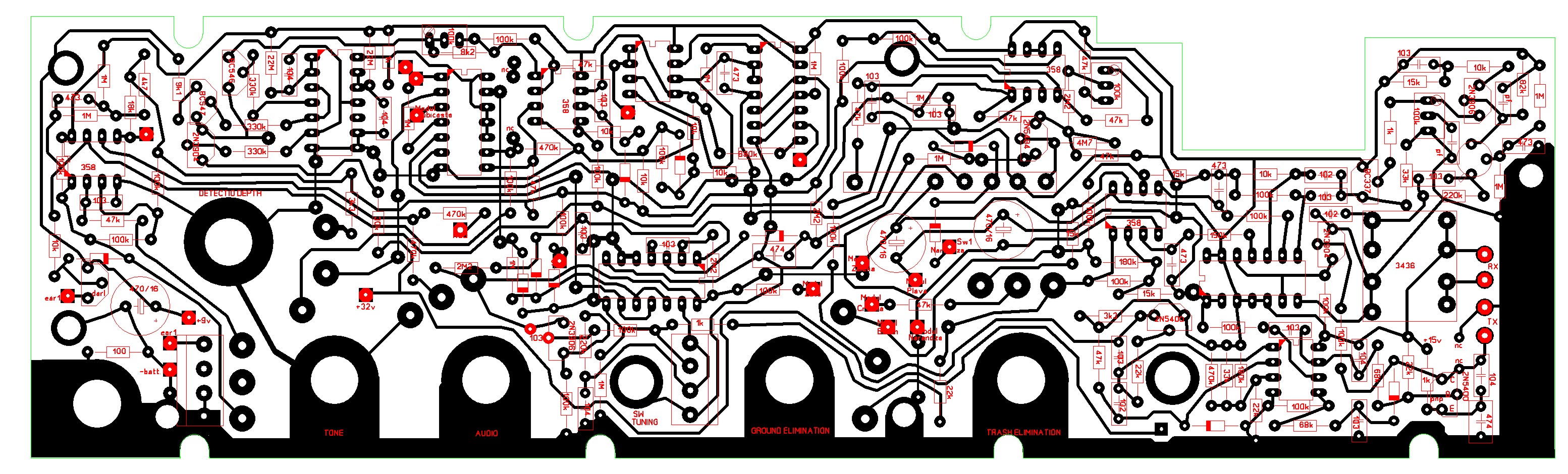

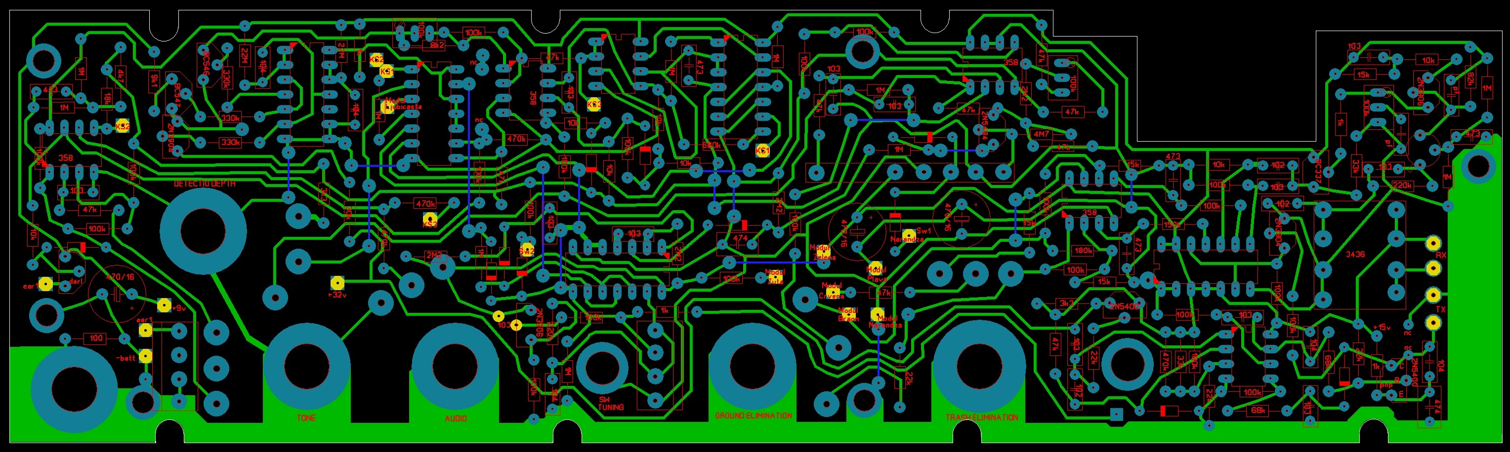

            For those who can't open Sprint Layout files:

                  for garret master hunter.
                  crossfire coil information:
                  TX 2.382mH 0.67mmAL 30cm diameter 55 turns.
                  RX 1.5mH 0.55mmCu diameter ? I did not measure.
                  TX 2 156uH 13 turns 0.67mmAL
                  green wire 390k - pole.
                  white tx coil driver tip
                  380k resistor between tx 1 tx2

                    thanks ivica maybe this could be made into an interesting project, re done with modern components and a plastic enclosure, when i started messing with detectors it was early designs like this, i found they work really well, the main drawback with detectors like this is how heavy the were.
                    that is something we can work on today.
                    i still love a non motion analogue machine, the other problem is its a garrett design, and they can be a bit snotty about their stuff even stuff this old.
                      corosfıre.PDF
                        Exactly my thoughts, since i have it laying in a dust; i thought to give it a try. Integrated circuits on this one are with skrathced labels, most of those i am not sure about. But i think it would not be a problem to "decypher" them.
                        I had to stop for a while with works on it, due other responsibilities, but for sure i intend to continue. And as it progress i will post here new things.
