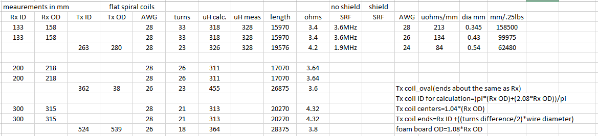

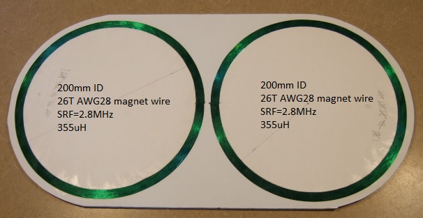

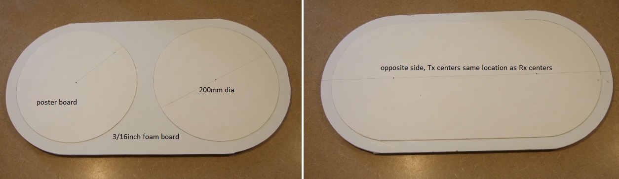

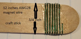

    Thinking making some figure8 Rx coils for bipolar Tx. 12 volt battery, 7V Tx supply, about 1.2A peak at 160us on time, 2000pps, about .25A average coil current. (fig8 coils.png)build specs with calculations. (spice zip)for each coil using calculated specs. Anyone see something I should consider changing? Anything I'm missing? Was making some wire targets awhile back with magnet wire. Was surprised that I could detect 12 inches of AWG28 magnet wire since coil I was using has about 2000 inches of AWG28 magnet wire(133mm fig eight). Could detect 12inches of AWG28 at 2.5 inches, 12 inches of AWG26 at 4 inches.
    200mm figure8 Rx, both coils wound the same direction.
