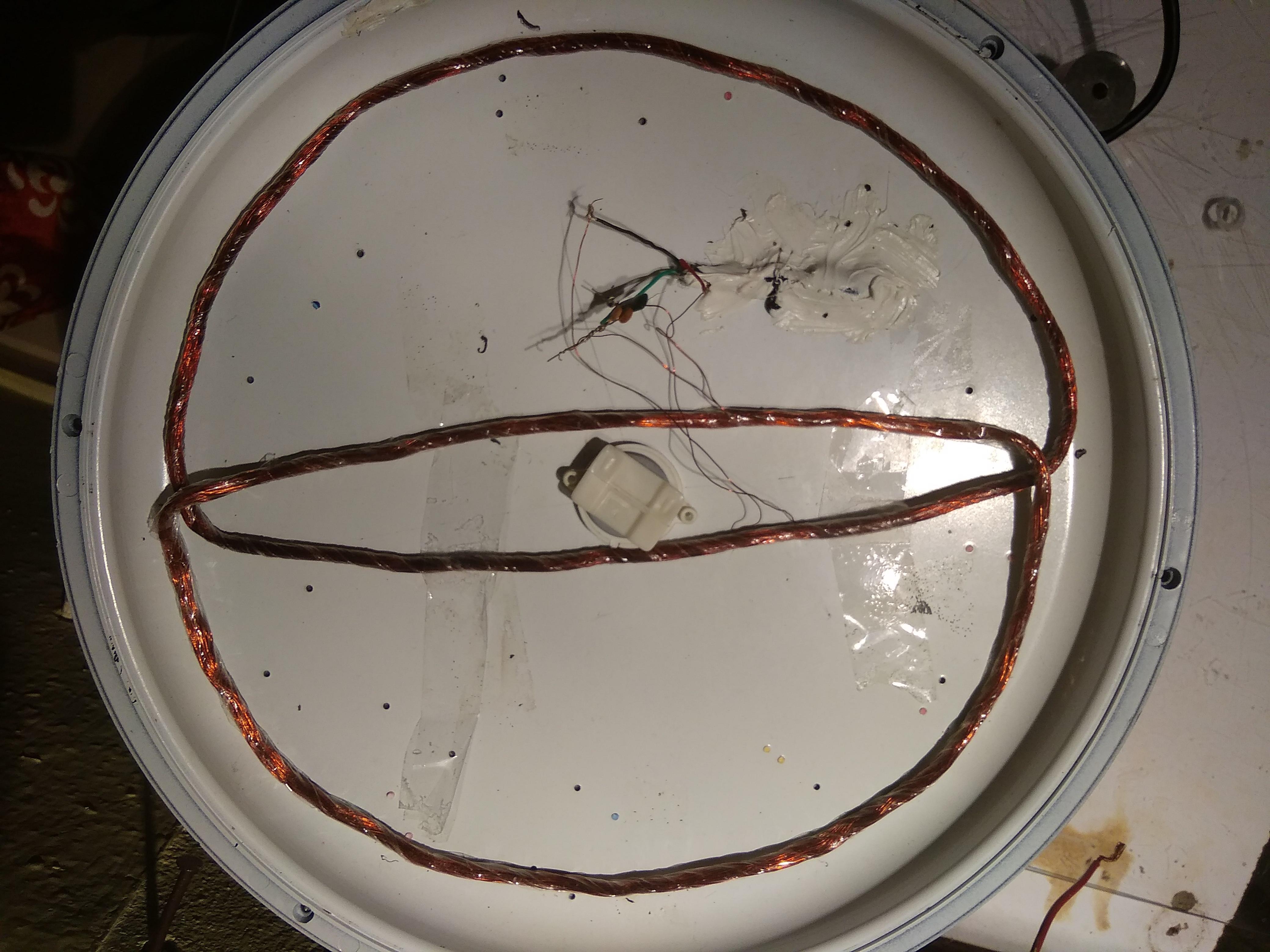

    Does someone has a printable image/document with the shape with the exact dimentions of the TGSL DD coils?
    Thanks!
    I'm not sure if this is what you are looking for. I put my first TGSL coil, as described in the Geotech docs, into this shape and it fits perfectly. It is somewhat ugly, but functional.
      https://www.thingiverse.com/thing:2235046/comments
      Thank you so much, I was referring to the formers of the coil windings but thanks anyway.
      I was searching for the forms to build the coil (winding) with perfect dimensions because the drawings from the docs does not have exactly the desired sizes when printed in paper (for example 137mm x 255mm) but I just resized the images do the desired sizes and printed them and it worked.
      Thanks!

          Originally posted by rajesh View Post
          [ATTACH]56081[/ATTACH]
          Nice looking, Rajesh!
