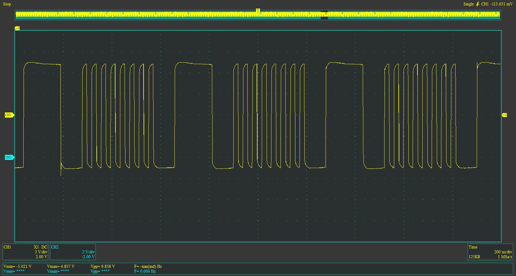

    Guys, what is the amplitude of the TX voltage in ML Explorer and E-track?
    No one knows? C'mon guys
      My recollection on the Sovereign is 10v-pp. I've not measured the Explorer/E-Trac but they all have the same TX waveform.
        Thank you Carl! I also measured approximately 10V with my cheap oscilloscope, but I tought the MF machines generally use higher voltages and I tought TX circuit is not OK.
          That looks correct.
