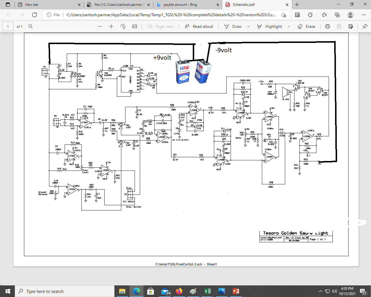

Name:	TGSL 18 volt.png
                          Originally posted by rajesh View Post
                          [ATTACH]56142[/ATTACH]
                          What this is for??, why the 18v?
                            entire 18 volt +9 volts & - 9 volts where -5 volts is - 9 volts
                              Oki, but what happen when i do that?
