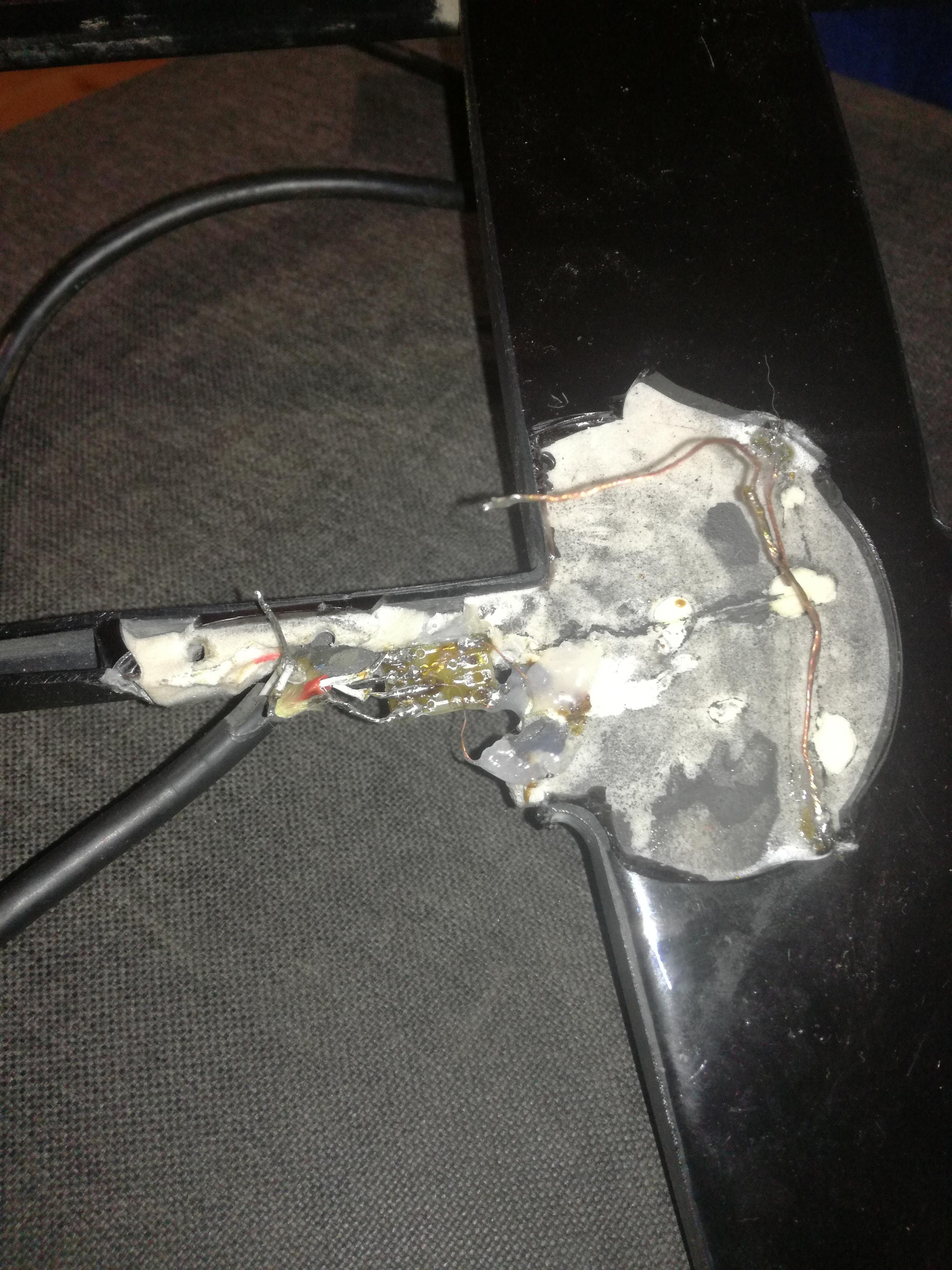

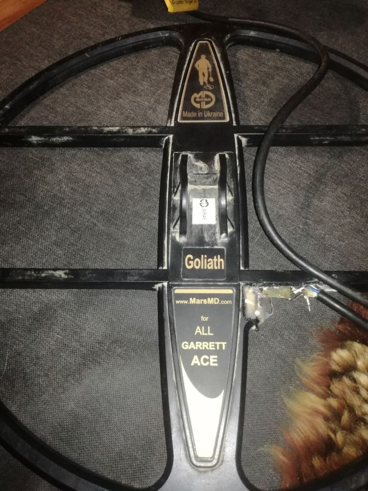

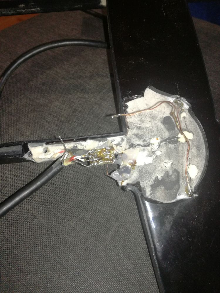

Goliat for ACE - help needed.
There's info on the forum about the ACE coils, if you search.
This thread has some info: The receive coil has higher resistance, like 30 Ohms, the transmit is much lower, like 3 Ohms, that should help you work out which wires are which.
