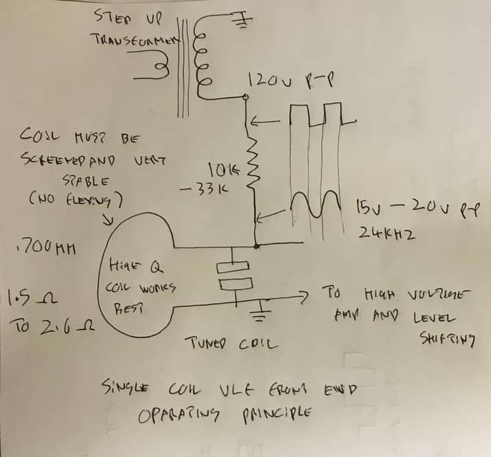

          Hi, everyone, I want to ask a question. Is there a VLF metal detector that uses a single coil? Does it have a corresponding patent? Part of the coil passes through the transformer, and the other parts are completely unchanged.
            Have a look at this thread -> Minelab Go-Find
              Hey, Qiao Zhi, I saw it.
                  Its owner modified a single-coil machine and sent a video of its work. I think it is very difficult, and it may be a false thing.
