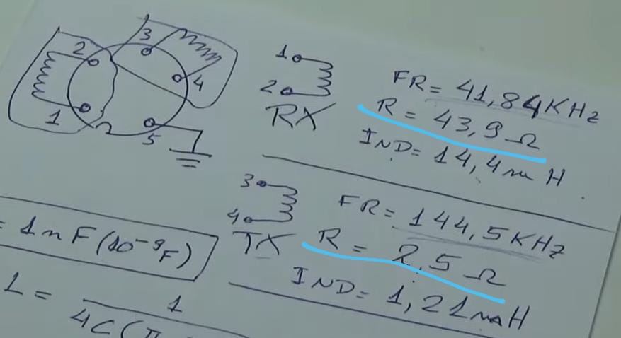

    Hello everyone, I recently acquired a TX850 metal detector where I noticed that the inductances of the coils were very close to those specified by Ivconic, both RX and TX, it was then that I performed a quick test and observed a good operation.
    Just as it worked on Ivconic SMW I believe it works on his IGSL Musketeer coil version
    I will try to record a video to demonstrate how it works.Click image for larger version

      Fiz um pequeno teste usando a bobina tx 850 para demonstra??o
      https://youtu.be/IZKnrEl9qJ4

        I am surprised with coil specs, I expected different ones.
        TX850 supposed to be direct copy of Fisher Gold Bug!?
