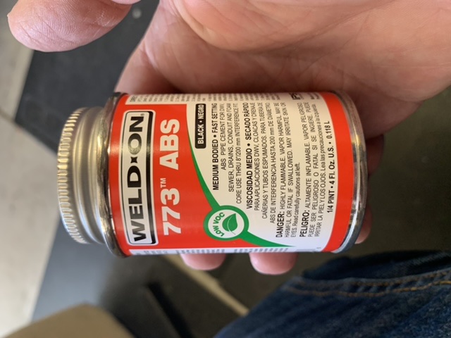

    Anyone tried this Weld-on 773 ABS glue for tab repair or coil housing assembly. Says has MEK and acetone. MEK by itself is banned here in CA.
    I have used ABS pipe cement many times. Make sure there's plenty of ventilation, it really stinks, the solvents in it are strong.
    It should be fine for coil housing joints. But probably inadequate for lug repair ... it's not super strong, and retains a bit of rubbery nature to it. It works fine where there is lots of bond area, such as the overlap on ABS plumbing pipes.
      acetone will melt ABS shavings keep adding shavings until its a thick goo.. the goo will evaporate leaving the ABS very nice for mending stuff
