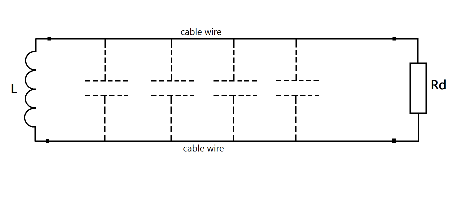

        My understanding is that the biggest problem is the coil cable. It usually introduces more parasitic capacitance than the coil itself:
        As shown on the image, many parasitic capacitances exist along the coil cable and their total equivalent capacitance is a sum of their individual capacitances. One can think of the coil cable wires as two long plates of a capacitor. To reduce the capacitance of this capacitor one can:
        1. Reduce the area of the plates, e.g. use as thinner wire as possible, and use as short cable as possible.
        2. Increase the distance between the plates, e.g. increase the spacing between the wires.
        If the cable is shielded this adds even more parasitic capacitors between each wire and the shield.
        Moving TX stuff out of the control box seems pointless to me. It usually contains metal bulky parts (big MOSFET, sometimes heatsink, large damping resistor, large capacitors) + additional wiring for power supply and gate drive. I don't think it's worth it.
        In case of separate TX/RX coils, moving the preamp closer to the coil seems to have more sense at the expense of some additional wiring. I personally haven't tried that.
