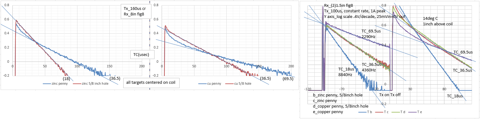

              If I place a US copper penny (70us tau) over one of the figure8 Rx coils, separate Tx coil causing a target signal I can cancel the signal by placing another penny over the other Rx coil with my PI. Probably any target with the same tau (70us) would work. Can't cancel the signal with ferrite and a wire loop (.5 to 1us tau). What is different with a VLF detector that can it cancel the penny with ferrite and the wire loop?

                    The difference is that in a VLF coil the phase can be quadratured into an X and R signal. If you tape a penny to the coil you get an RX signal with a certain phase. You can cancel the X component of that phase with a ferrite, and cancel the R component with a loop of wire.
                    In PI you have exponential responses that are all purely resistive signals. When you tape a penny to the coil you get a particular exponential. Adding the ferrite (which is essentially an instantaneous decay) does not help. And adding a target with a different tau will subtract from the penny but never in a way that nulls the penny.
                    So even though phase and tau are closely related they behave differently in circuitry. To throw in another twist, the Tarsacci uses a square wave (voltage) drive and an IB coil so that the target responses are exponential but contain both reactive and resistive components. I've not tried it but it seems that ferrite could cancel the reactive component but my thought is that the resistive decay is still unique to the tau of the target.

                      I've been placing the offset target (penny) on Rx coil A. Null target (ferrite and wire loop or other correction target) on Rx coil B. Couldn't adjust null with ferrite and wire loop. Easy to adjust null with like targets. Thought zinc penny and copper penny with would null better than it does since tau's are close. Attaching pennies chart I did awhile back.
                      First two scope pictures, Tx off. Third picture, Tx on then off.
