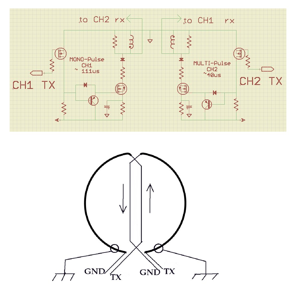

    Lately I've gotten interested in building a PI with bi-polar drive.
    And so I'm thinking that a differential wound DD coil would be the way to go, with each channel's receive input tapped from the opposite channel's inactive coil. To eliminate (adjacent channel interference (more like next-door-neighbors), two separate receive channels will be used which will get combined post integrators.

        I'm not looking for a GPZ style coil. I need a DD coil but with wires reversed on one side. I thought there some other folks experimenting with bi-polar drive but I'm just not
        ready to accept a bi-filar coil's extra capacitance, so bi-filar wound, no, but maybe a dual-field or other concentric IB would work, given appropriate attention to shield connections (!), but D-twisted-D seems simplest.

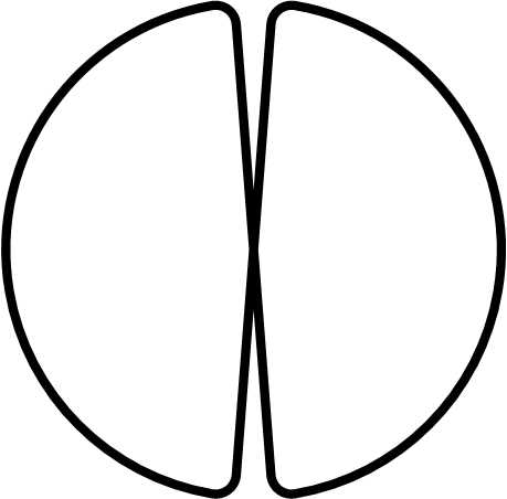

          When you said "GPX-7000 DOD" I assumed you meant GPZ-7000 because there is no GPX-7000 and the DOD is used on the GPZ, not GPX. In any case, there are multiple ways to do bipolar. What I understand you want to do is have 2 TX circuits drive 2 TX coils in an alternating manner. A DOD coil won't help, it only has 1 TX coil (and 2 RX coils). What you want is a DD coil where both windings are identical. But it doesn't have to be DD, the coils can be co-located; they don't have to be balanced. However, an IB coil may let you sample earlier.
          Offhand, I don't know of any commercial coils with matched DD windings. I also don't recall that any Minelab patents covered any particular coil configurations. Finally, I don't know what you mean by "D-twisted-D"... do you mean a butterfly coil?

            Sorry if I sometimes don't express myself plainly... hey I got the ML models mixed up. I'm not very familiar with their offerings.
            Here's what I mean. Two D coils side by side, mirror images except that one is wound the opposite direction from the other.
            Each channel's receiver taps the rx signal from the other channel's transmit coil. It will be a negative excursion and very weak in relation to what's on the other channel, so extra amplification is on the menu. I considered using a bi-filar coil and/or differential amplification but ruled those out. I think a differential signal path would be detrimental because the two opposite ends of the coil see temporally disparate signals that are in no way even approximately equal. That is to say, I would rather treat each channel as more or less independent.
            Does that sound workable? Sometimes I go of in the wrong direction. When I first started this project I was expecting to be cancelling the ground signal with bi-polar pulsing. Then I started reading again and realized my mistake, so it's a good thing I hadn't expended too much effort on PCB art because what was there got ripped apart, but circuitry is simplified, so its a net plus.
              Yes, what you want to do will work, except that your diagram actually shows both coil wound in the same direction. That is, starting with TX and ending with Gnd they are both counter-clockwise. One needs to be clockwise.

                OK I see. Talk about a false start. I think you have just stopped me from erroneously trying to use a DD coil and for that I thank you.
                Er, so what happens when pretend I know what I'm doing, and I reverse the leads on one side. Is there a name for THAT? The inclination is to call it a DD but I think that would be wrong. It seems like such a picayune little detail except that that it's really not.
                  Still a DD. DD describes the windings' geometry, regardless of how they are connected.
