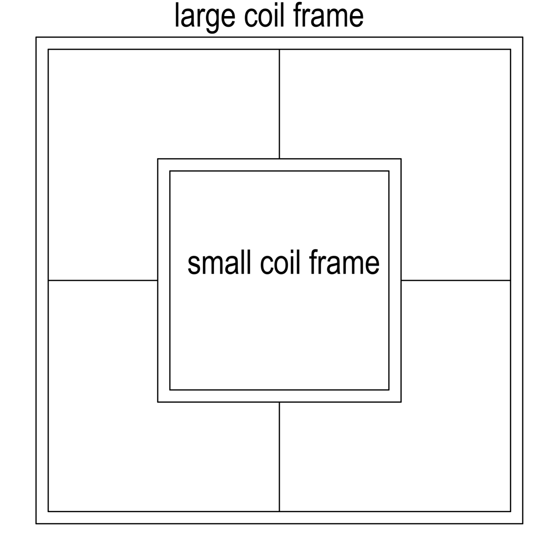

4. Coil diameter and shape relative to target size and time constant.
A. Round coils have the most inductance for a coil perimeter.
B. Oval coils or round coils made thinner into a more compressed oval shape will have less inductance as the oval is made thinner and wider.
The above things are variables that can begin to interact with each other based on:
1. Target size.
2. Target time constant.
3. Lowest operational delay.
4. Coil size and shape.
5. Target depth desired.
6. TX pulse rate
7. Any RX integration techniques being used and number of RX pulses being integrated.
