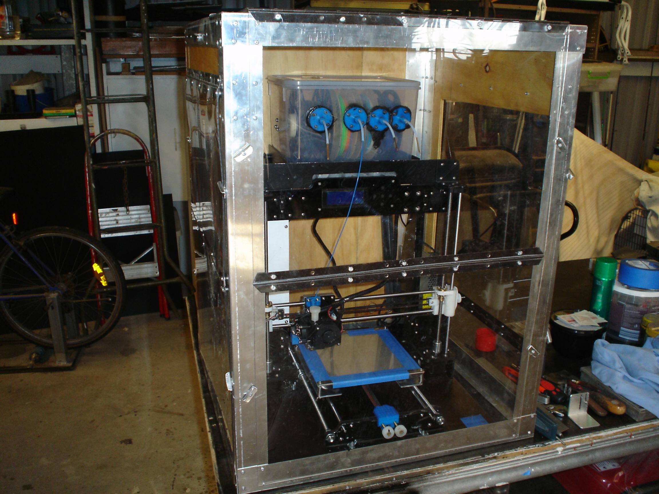

                    Looked at manufactures "tents" and I am not impressed, so plexiglass it is. Funny how one job always leads to another.
Name:	Printer and enclosure. .jpg
                      This might give you some idea home brew as you can see.
                      Regards, Ian.
                        Originally posted by IBGold View Post
                        [ATTACH]57941[/ATTACH]
                        Regards, Ian.
                        Thanks Ian
                        The design I have in mind is very similar to yours. Aluminium angle frame, door at the front and removable sides. Must say that I envy the space you have. My workshop is quite small so the overall size of my enclosure will be just sufficient to house the printer. One challenge that I need to overcome is that the build plate moves forward on completion of the print. I either need to disable this function in software or design an auto opening door
                        Kind regards
                        Martin
