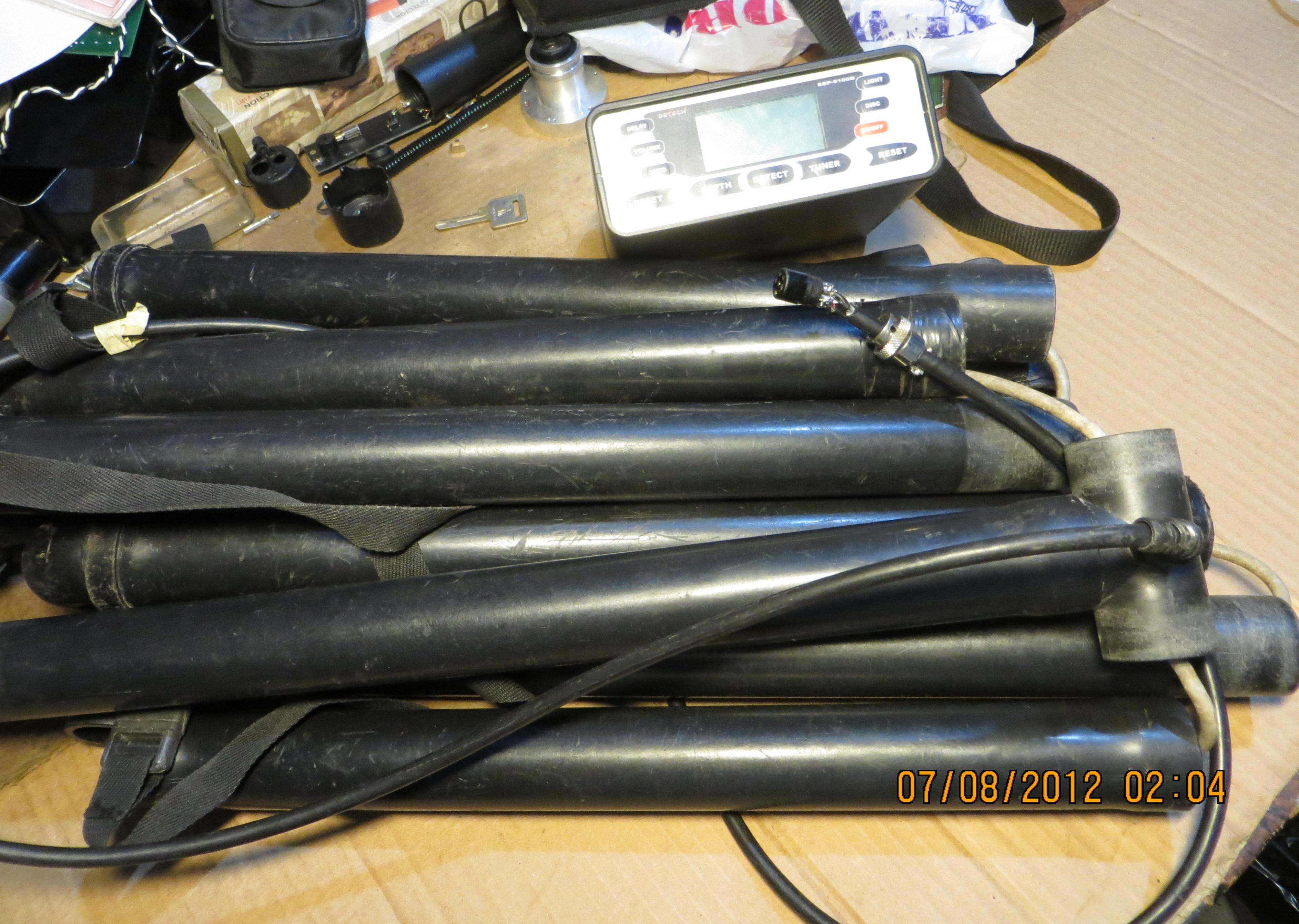

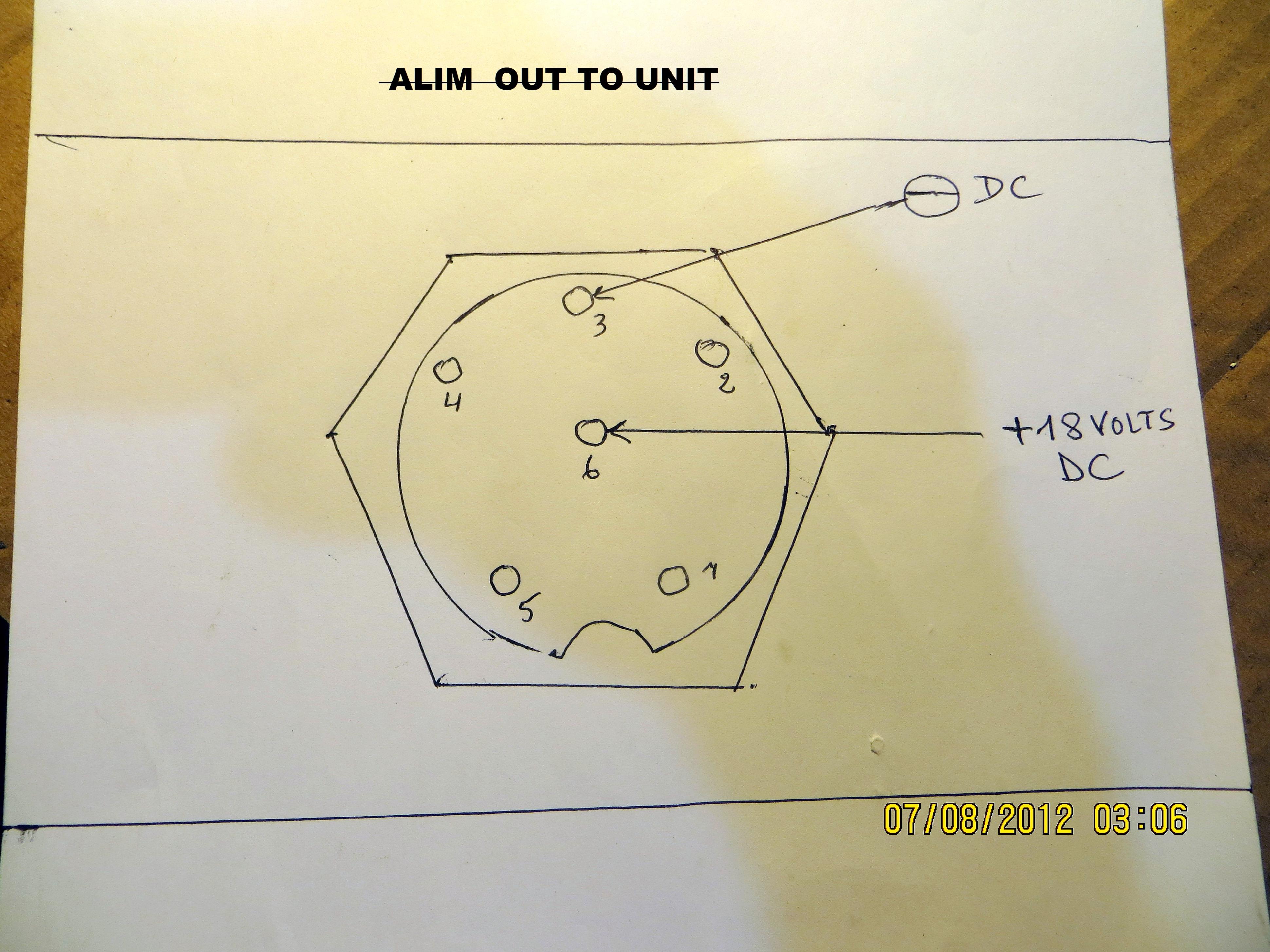

    they bring me an SSP 5100bg from detech, my problem is as follows: it is equipped with a squared coil with integrated magnetometer, the cable is damaged at the level of the plug, the cable is made up of three pairs: red + braid, green + braid and white+braid and I don't have a pinout to resolder these wires in the right place, could someone help me, thank you

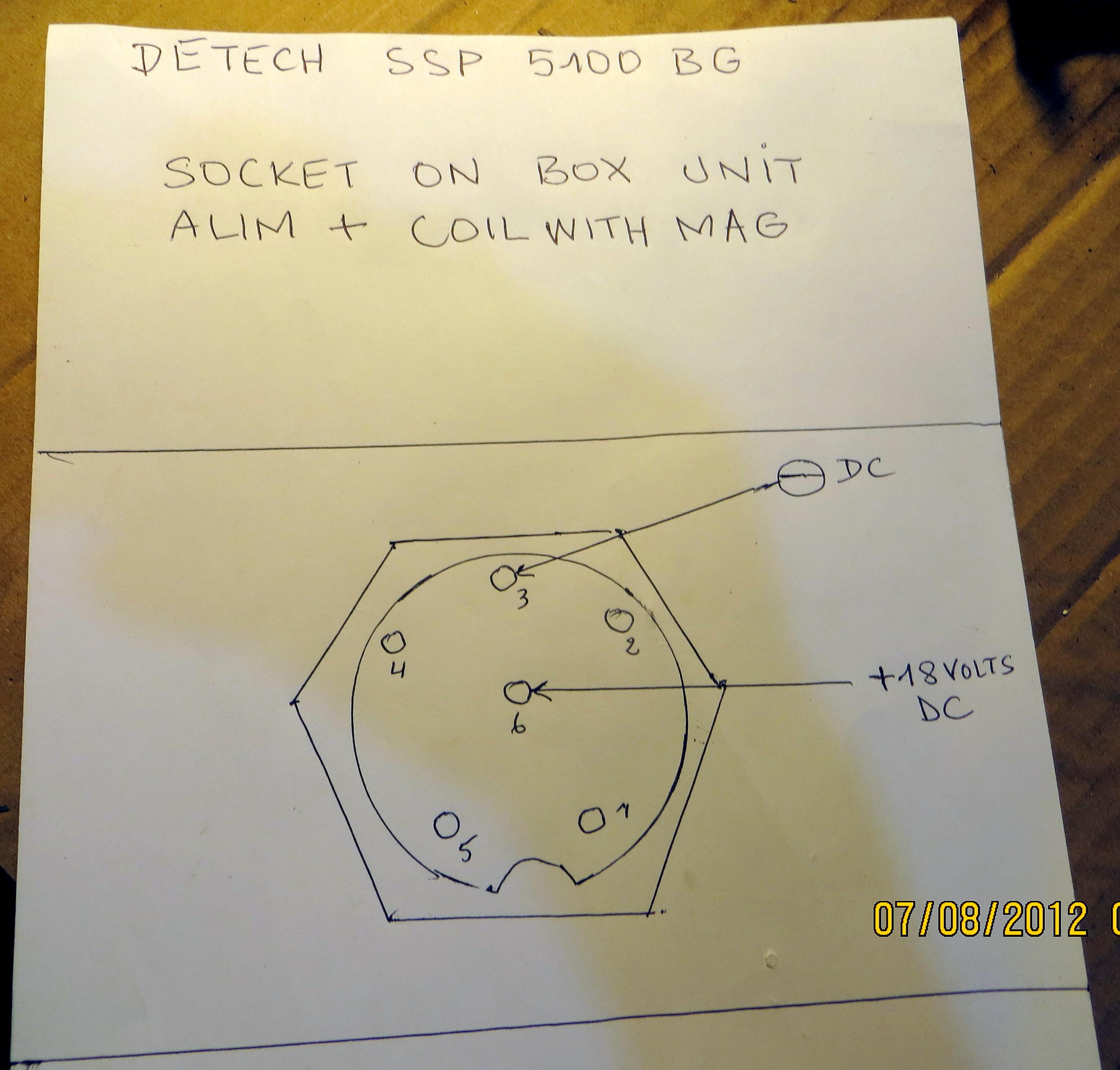

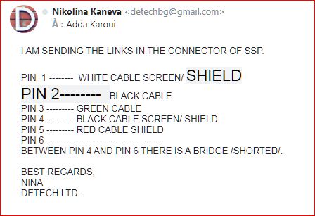

      hello to all, it's OK for the pinout socket of the SSP5100, I contacted DETECH Bulgaria and they kindly provided me with the pinout of the squared coil with embedded mag, like what, their service is present and answer anyone all over the world, it's great, i attach their diagram to anyone who needs it

        Hi, it's me again, I soldered the socket according to detech and the device turns on, you have to connect a coil for the device to turn on, all the functions working except the coil which detects nothing, I measured the resistance between the wires and the values ​​are infinite, the coil is new, does anyone have an idea before I open the coil
        thank you

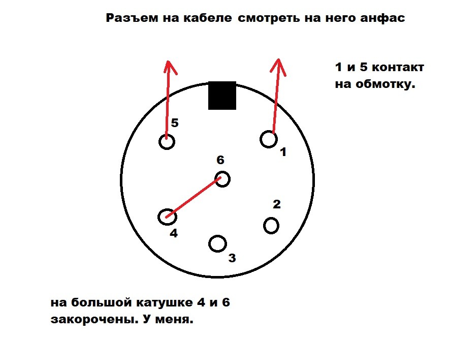

          Сопротивление обмотки измеряю между 1 и 5 контактом. Сопротивление равно 2 ома.

              good evening and thank you for the diagram, I have already found the pinout, and I was able to start the detector because I discovered that the detector does not work inside because my house is full of construction iron but it works very good on the outside and I was able to return it to its owner in good working order

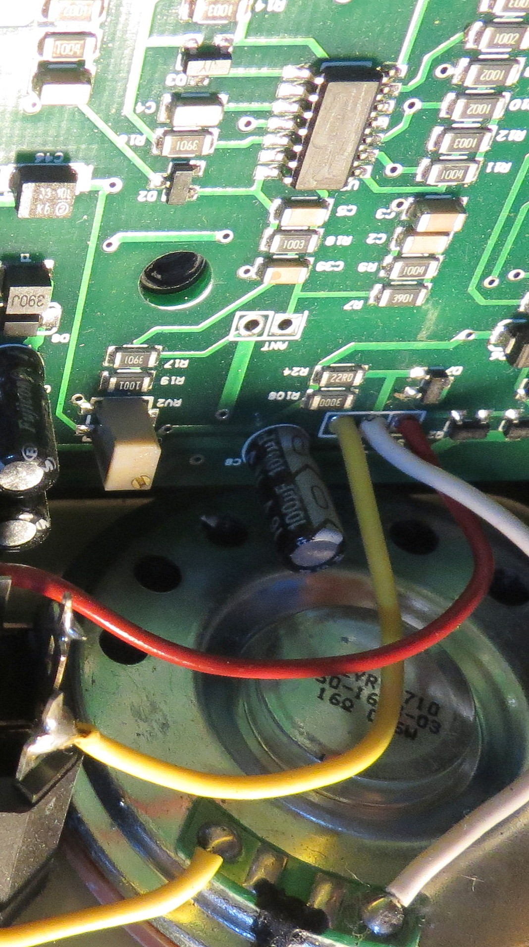

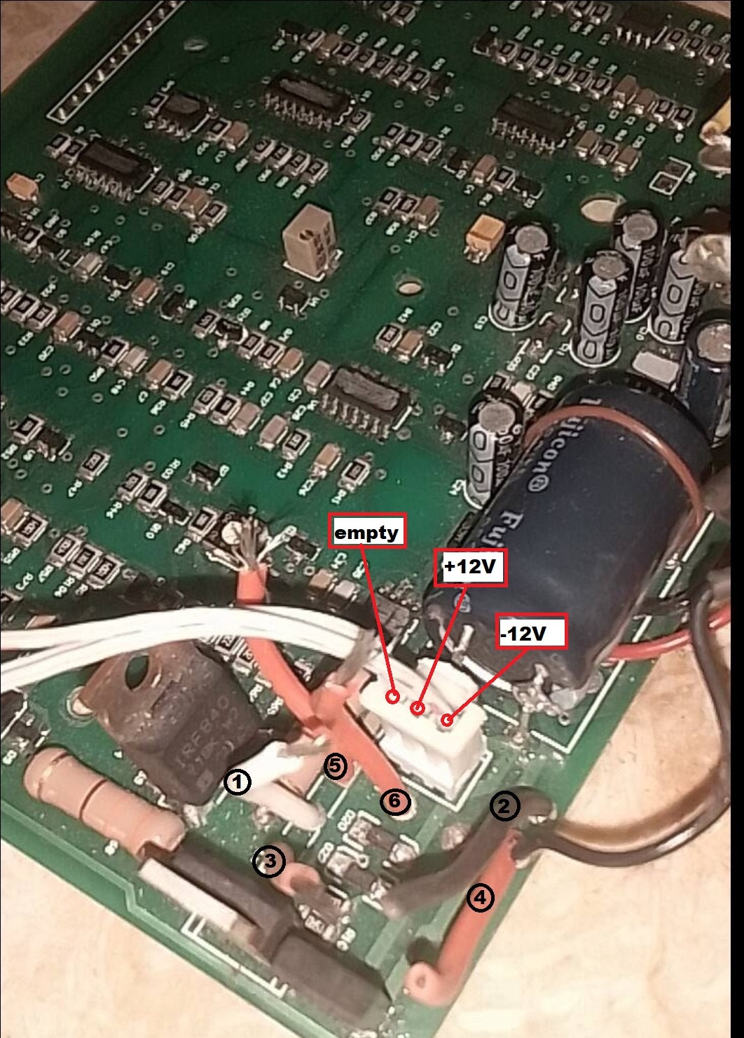

                I opened my SSP 5100. I saw a burned-out resistor. In the headphone circuit. I don't know what the denomination is. In this theme there is a desoldering for a large frame. And how to connect an 18-inch round coil. Is there a scheme? I want to make a coil myself.
                  R24 = 22R0
                  see pics all i have
                  AK48

                      I want a picture of the device to rebuild the wires are cut

                            AK48 Thank you very much. I didn't even hope for quick help.
                              I marked the connection to the connector with numbers. How the connector is designated is higher in this thread. To clarify: 1-white, 2-black, 3-brown, 4.5.6-red +12 and -12 battery powered.
