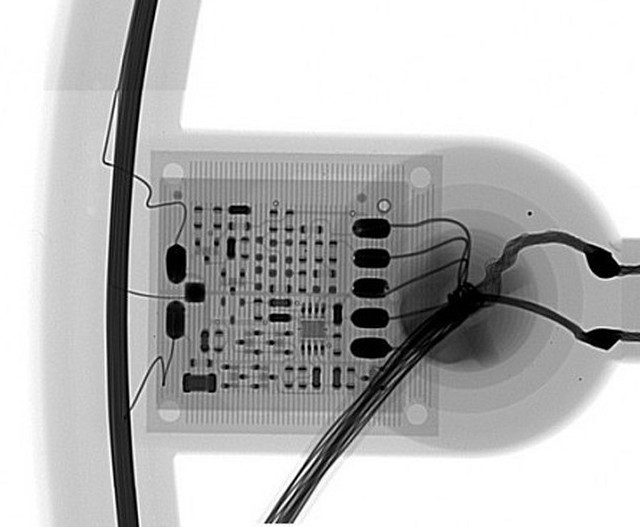

    I created this thread to discuss and share our experience about tiny PCB of vanquish which is located inside of coil.
    Yesterday, i opened my vanquish coil with difficulty and could reach to the PCB.
    The PCB is strongly protected by ML because it has a different material for protecting.
    Anyway, i almost could get the PCB but a resistor and three transistors is crashed during opening.

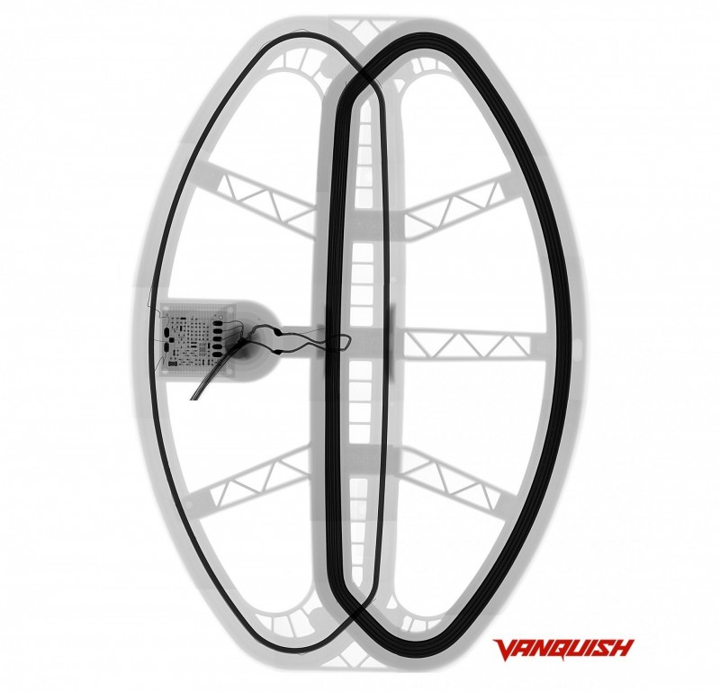

    Unfortunately, i don't have the expertise to reverse engineer it. So, i share its pics (PCB, X-ray of coil and conceptual schematic of its pins) here. Maybe someone can help to do it.
    X-Ray1
    X-Ray2

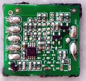

    PCB

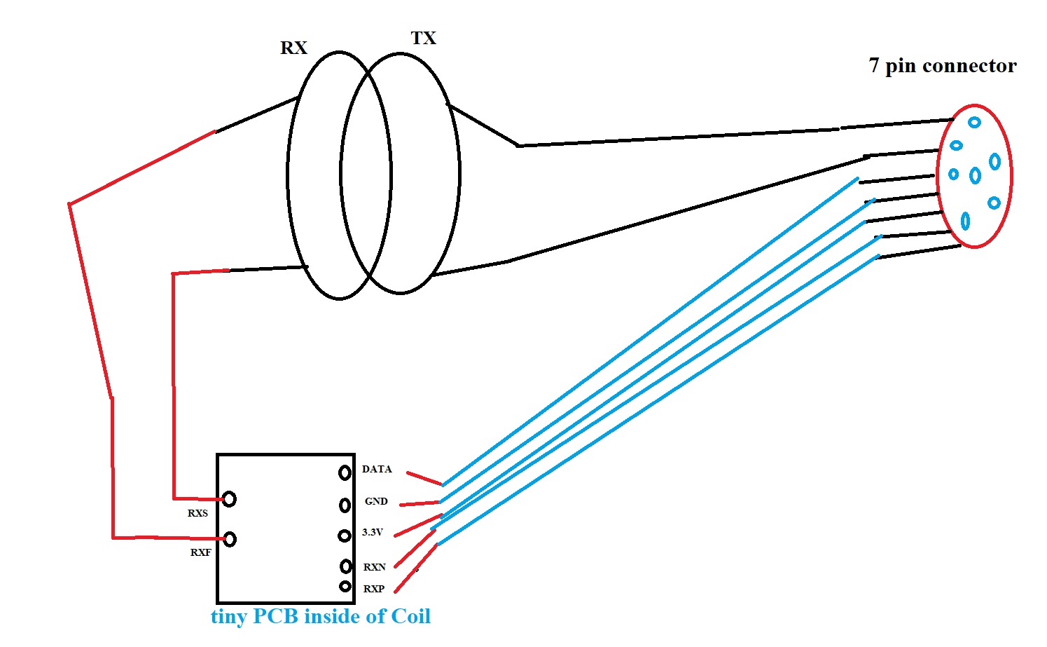

    I forgot to say, IC opamp of the PCB is T062 (i think it's TL062)

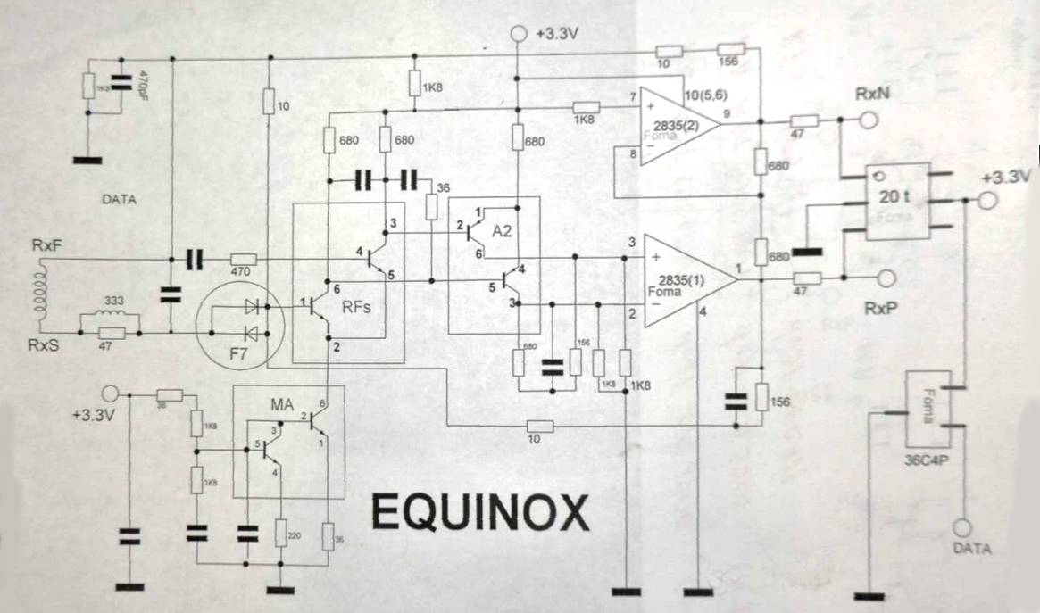

    I also realized that Mr. Foma has been able to draw the schematic of EQUINOX. I think base of the Vanquish and EQUINOX pcb is the same. For better understanding, i also attached Mr. Foma's schematic.
    Foma's schematic (EQUINOX Schematic)

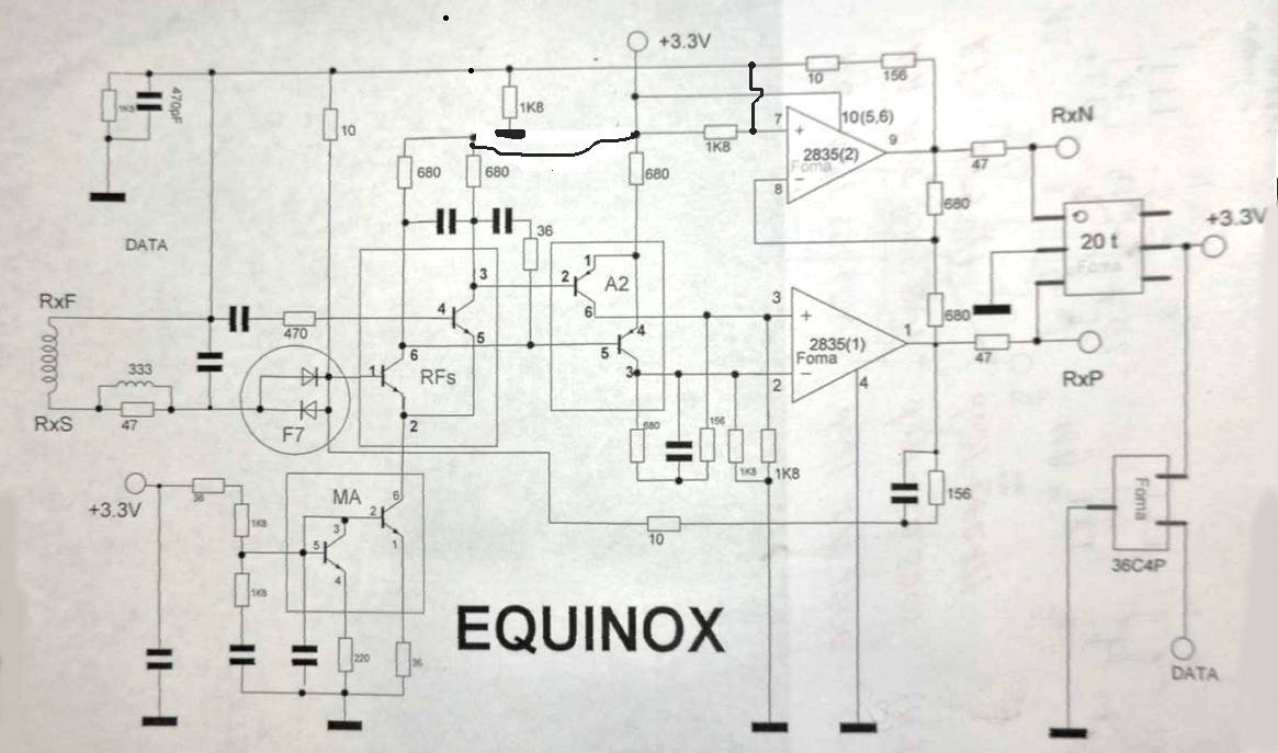

    Mr. dbanner also has been pointed to a possible mistake in Foma's schematic and edited it. I also attached his version.
    I hope this information can help to reach a correct schematic for vanquish tiny PCB

          I attached a higher quality photo.
            Dear kt315
            Do you think 36c4p is diode ?
              pin DATA is digital signal, in my opinion. some kinda one line of the interface. while i really do not know
              what Foma wanted to say.
