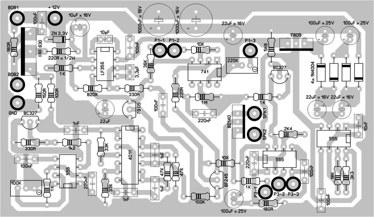

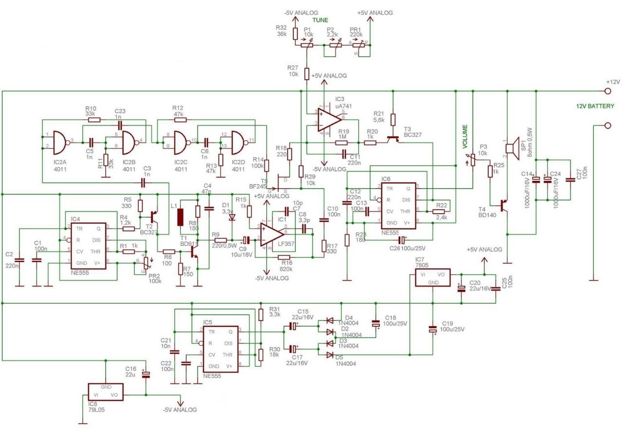

                  I maked a PI Polones (AVT–5196). I upload some attachments
                  I dont have oscilloscope.
