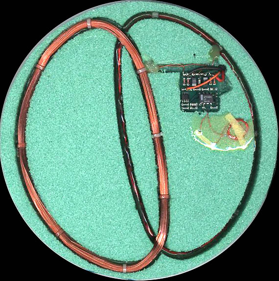

Opened my tesoro widescan coil

      ML uses especial strip connected to preamplifier, on its input. or, you can show by pic your coil, your coil without the pre amp?
        ... for example

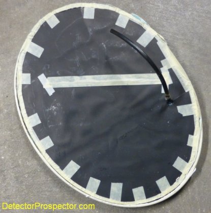

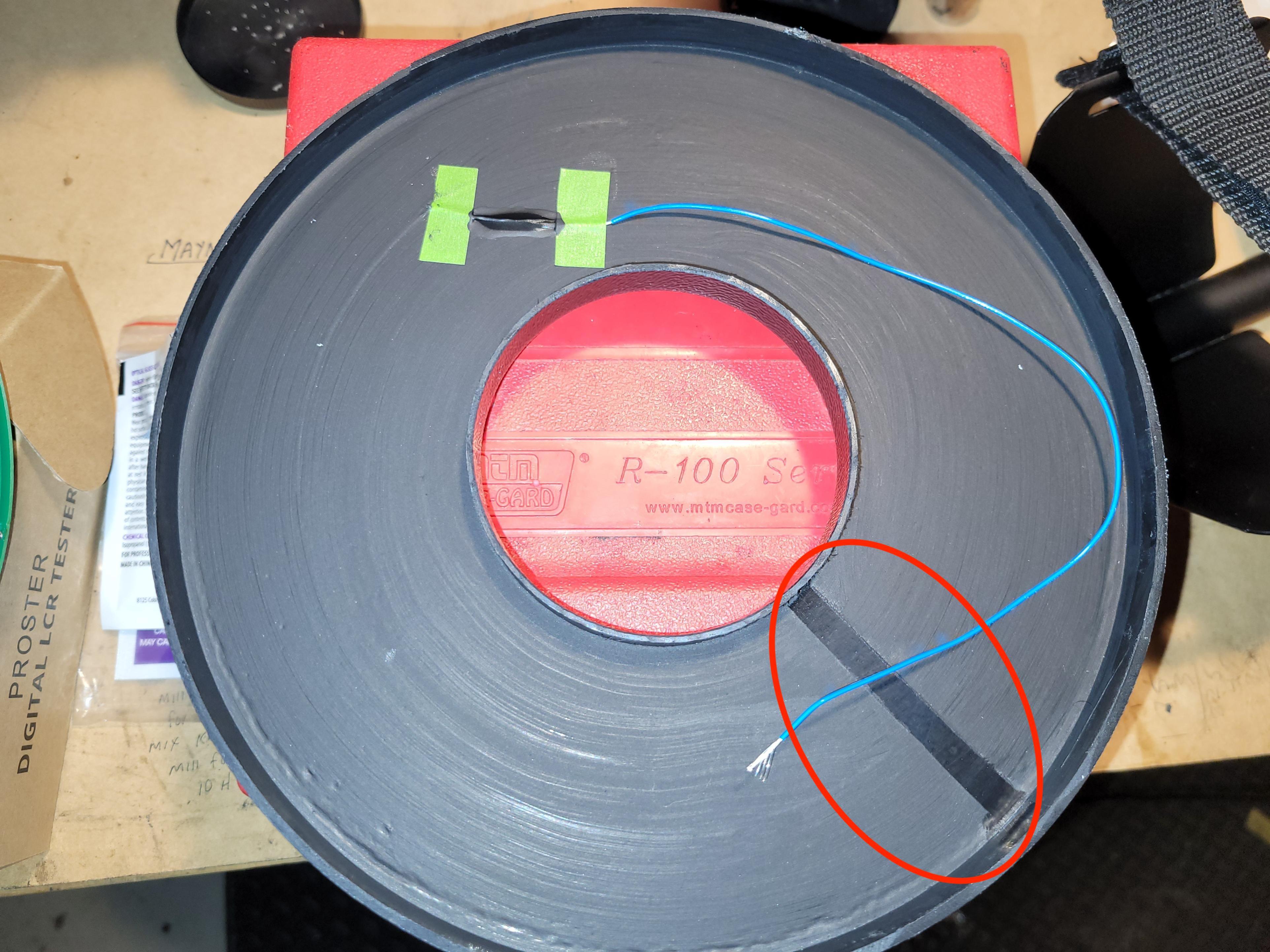

          In this case I'm asking about the dfbowers coil casing having a strip (line) not painted with graphite. If having this not painted line is really needed (maybe because is coil is a concentric?), because I can't see something like that in Minelab commander coils (DD) shielding, like in the images below:
          dfbowers casing (have a not painted strip / line):

              understood. the gap perhaps needed if the layer has very low resistance, Ohms. without the gap the layer is like a short-circuited loop
              for EMF (because TX power is EMF itself, the nature). you maybe want to reduce losses. has some sense. but if you do (right do) high resistance layer
              you sure do not need doing the gap.
              a case with discs, NO gap between discs. be cause high impedance graphite layer.

                  "In Dons document about shielding he masked off a line down the radius of the housing in order to stop eddy currents in the shield. I just did it anyway even though he found no difference with it and without it on his designs?he also said it was best practice." Quote from here:
                  http://www.adrianandgenese.com/blogg...housing-build/
