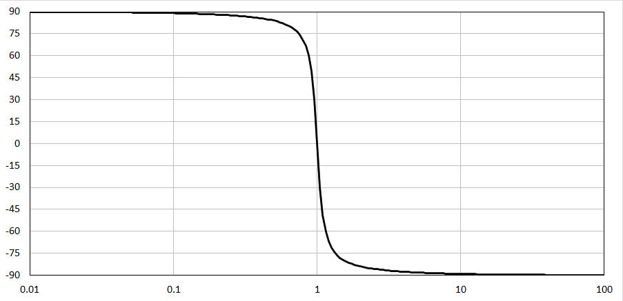

      Adding a parallel cap to the RX coil makes it into a bandpass filter and at the resonant frequency the phase shift rolls from +90 to -90 degrees at a rate that depends on the Q. Suppose the RX coil is 1mH and has a series resistance of 10Ω and we are running the TX at 10kHz. The required cap value for resonating the RX coil at 10kHz is 253.3nF and the Q is 6.28. The resulting phase response looks like this:
      This is normalized so that '1' means 10kHz. At exactly 10kHz the phase slope is very steep so any phase noise on the TX or phase modulation due to targets will result in a wildly varying phase error. So instead the RX resonance is offset (preferably below the TX frequency) to get it to a lower phase slope.
