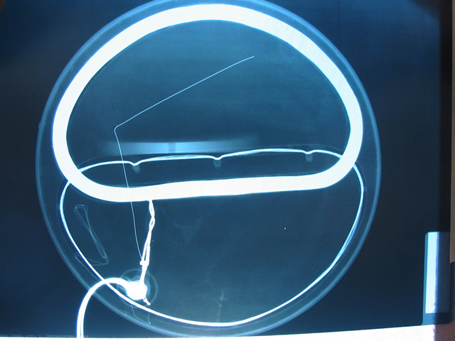

    Hello forum friends, here is a radiograph of the Minelab 11inch -DD for the GP 3000, Very nice adjust, see the long nail (mesure 9,5 inch) in the center and another strange things!!!!

    I suspect the long wire with a bend, is the drain wire for the shielding. The shadowy feature in the bottom left, inside the receive coil would be the few turns needed for the balance winding.
    Ferric Toes
      Sorry, wasn't aware that a DD coil needed a balancing winding. Am I missing something here?

        The way Minelab make them, you do. The two coils are mounted in grooves in a rigid styrofoam former. They are epoxied in and can only be approximately balanced in this way. A few turns on the end of the RX winding is positioned to give a good balance, then that is epoxied. I have one open, and can see that this is what is showing on the radiograph.

          Some ML mashines have 3th coil (1uH) just for adjustment (38sm-DD) and correction of the phase
            So, let me clear this up...the large THICK winding at the top is the Tx and the thin weedy one at the bottom is the Rx?
            I heard Minelab used very low resisitance Tx coil to stretch out the current rise time, and switched off the Tx pulse whilst the current was still rising. :confused:
              Correct on all three counts
