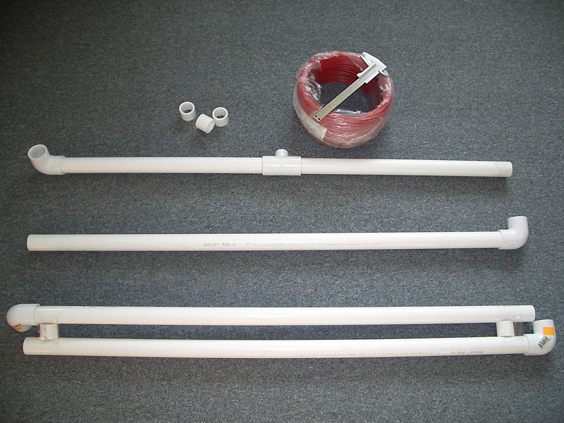

            I took a multifilament wire because it must be some elastic. a diameter 'of copper' must be not less than 1,8-2 mm.

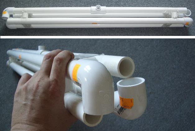

                Number of turns & damping resistor depends on the PI you're building it for. I believe the 1m x 1m coil I made ended up close to 500uH with 8 turns.

                    I think I used 24AWG or something like that. Damping resistor is found by looking at decay settling with an oscope. If you have no oscope, then adjust the damping R until you get max sensitivity to a given target.

                      How you construct your coils square o radial ????
                      Resuming:
                      24 awg
                      8 turns
                      1mx1m if square or 1m diameter if radial
                      is ok ???
                      Tahnk
                      [email protected]
                        Not sure I would use a pot for damping, instantaneous current might be a tad high for it. If you do use a pot to find an optimal value, I would then replace it with a fixed resistor.
                        I built a square coil. Try it with those parameters, see what you get.
                        - Carl
