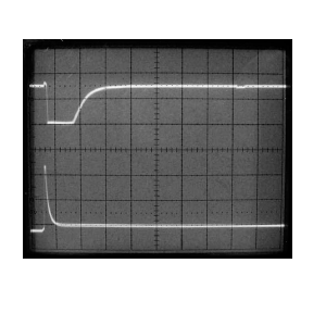

                            Hi nncunew,
                            First, I have not built the Sandbanks PI so I don't know much about it. I will try to help you by giving general information.
                            First, my guess is your new coil has an inductance of somewhere between 500 uh and 700 uh. As such, I would start out with a damping resistor of 470 ohms and see what it looks like.
                            You can look at the output of the preamp (IC 4, pin 6). The signal should like much like the top trace in the picture I have attached. The bottom trace is what the signal should look like at the coil.
                            You will notice in the top trace, the signal goes negative for a time and then rises exponentially and levels off. You want the signal to rise as fast as possible but not oscillate. If your signal looks like the top trace, you might want to increase the resistance of the damping resistor and see if it still looks similar. You can keep doing this until the top signal becomes unstable and has a wave or two in it when the signal rises.
                            Now, just looking at the Sandbanks circuit, I woud recommend you try to shorten the sample and delay time also. That will make the detector more sensitive.
                            Reg
