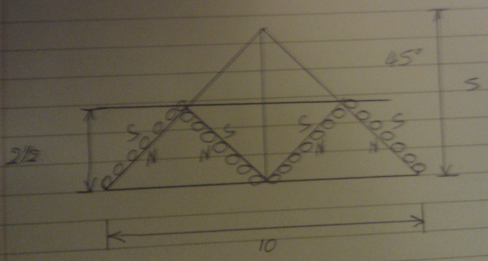

            ref ; conical coils
            yes , i see 2006 for the first post, it doesnt move fast on here does it ,
            a conical coil at 45 deg seams to have the answers, since then i have seen a pic on the net of a conical coil "IN" another conical coil, which on the face of it looks as though it would make the intensity stronger , and also recieve sensitivity better.
            which has lead me to draw the design below, interesting ??
            a conical coil 12 " wide at the bottom at 45 deg would be 6 " high and people may laugh at your metal detector search head,,but...........
            bellow the cone pointing out of the cone would only be 2.5 " high which is more acceptable,cross section of a circular coil
            so i rekon this is a pretty good basic idea , size shape acceptable,
            as far as performance goes appart from the bottom windings all the coils can only be spun one way so to speak when a field hits them, then only the other way with opposing field.
            the round bits are the coils with one diameter sepperation to minimize intercoil cappacitance.
            the square at the top to be removed, just made it easyer to draw.
            just had a thought , this design could have as many "cells" as req.
            here is just an inner ring and an outer ,could have another ring if larger surface area req.
            power loss / emmision should be good , sensitivity would be hard to beat.
            Last edited by DOOLEY; 04-30-2011, 09:23 PM. Reason: edited text removed a line didnt need to be there
              Well, it is an interesting idea, only trying will tell if it will work.
              What type of detector do you want to use with that?
              Tinkerer
                conical coils
                was thinking single coil pulse induction as tx should be on par with mono coil , but rx should be better .rekon this could be the answer to the pressent limit on depth for a given size of object.
                wasn't worried about lenght of wire / resistance as more would be good for rx,
                as far as tx goes , if amps isnt enough at 12v , will just drive it with 50 or 80v via voltage multiplier / blocking oscillator. built a few of those , got that down to a fine art.
                last night was thinking of adding extra "sides" either flat or 45 deg up, to try to "shape field a bit more , at the very least it would extent the distance the inner polarity has to go before it can loop back round and return.
                another crazy thought was , aluminium wire , less dense , lighter , poss a little more invisable on receive , ali wire still makes an electro magnet , hell power up a roll of aluminium shielding tape and it becomes a magnet.
                ohms/foot a little higher due to lower conductivity than copper.
                thought about carbon wire for total invisibility , but that stuff doent give off much , if any field as far as i know.
                poss having a go with the idea today.

                              conical coils
                              bklein , yep , true comparison with a referance is the only way , could be done with only one board though , just cut the track from the fet drain to the resistor going to the diodes , then tag one side for rx , leaving the fet for tx.
                              incedentaly , tried this , and if tx and rx coils are close enough (ie:wound together) then you can choose weather to have damp resistor on tx and rx or just rx , i found that with sepperate but close coupled tx and rx coils the output waveform is "clean" with just a resistor on the rx coil,
                              it would apear that the tx can be as raw and dirty as you like. and as a bonus the rx resistor can be allot higher , i got a clen signal with 3.3k so less signal loss also.
                              oh , dont clamp the tx with diode back to batt + it kills your rx signal , tried it , just to see , no harm done , it just didnt help.
                              oh i also thought of hall effect sensors as an rx idea , 2 main types , north or south turn on types or just south turn on types , but there not realy that sensative , need alot of field to turn em on , think due to internal circuitry with output either on or off.
                              now if someone made a hall effect say 10" round and flat just on its own , no extra circuitry , ather than maybe a built in amp , with a variable signal out that was very sensative then we would have our rx sorted no ??
                              as far as software goes , i shy away from that , as soon as i see a project on the net with a pic chip in it i click the red X.
                              i dont want all that complication , its like , if you have a poor tv signal , if you amp it many times you useualy just get a stronger crap signal , if the signal ain't there , you cant amp it, thats why i thought back to basics , find a way to get a stronger signal right at the begining rather than try to get what you want with fancy chips and amping it to the point that it's unstable and temprimental.
                              best sensitivity i have had so far is a 12" coil with 30 turns of 20swg for tx , and then would on top 120 turns of 30 swg for rx , not built a full pi yet , just the tx side and the first amp , and scope'ing it.
                              benifit with seperate rx and tx is single supply is only needed as return signal is 0v and up , not 12v and up.
                              downside is , all that extra copper , knock sensitivity as its adding to capacitance and effectivly "sees" all that copper as a target.
                              went for a 30 to 120 ratio for a bit of "gain" right at the start.
                              so my next experiment is ali wire 0.8mm (welding wire actualy) with some .65mm(60lbs fishing line) nylon as a spacer to reduce capacitance , either "solenoid" wound or my 2 cone idea , dont know yet , but thinking as ali is less dense then would poss be more invisible as far as rx goes.
                              hoping for many people to join in on this till we get it cracked , hopefully before the big company do it before us , then want to charge a pretty penny for the pleasure.
                              last thing , not allot on the net regarding focusing magnetic force or similar , so is it not possible ?? not yet mastered ?? or "they" don't want us to know the secret ??
