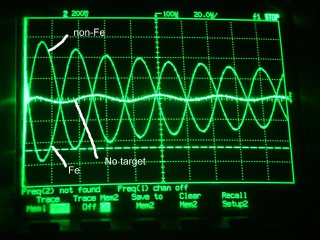

On the break, man! You not only will never see any of my advance in detector technology, or at least if you do, you will not be able to sell it to anyone, just because i'm doing this just for sake of pure hobby, nothing else, and everything will go public, but this is last thing people here are interested for. Instead, many people are interested in new RPI detector concept, so my post will be bit more technically oriented in that direction and maybe interesting to someone.Originally posted by Sean_Goddard View PostROFLMAO!!

This RPI idea, and related patent paperwork is among us for quite some time, apparently detector itself is still not. Some time ago i tried to replicate it based on US xxx. and find out some interesting facts. Keep in mind that i never intended to build complete and functional detector, just wanted to try method itself, just for pure curiosity. At the end, i abandoned it, continued whit some other concepts, but not because this one is non-working and/or fraud, just because it is too problematic to implement. Controversial, so to say. What i learned in the process is that following only patent data, one will not go too far whit this one, as expected (simply, lawyer's paperwork must include either black hole in it, or just nothing, usually goes that way). So, few issues i'm stumbled upon:
1. Coil itself. Due to detector operating mode, must be absolutely perfectly shielded to eliminate any capacitive coupling between TX and RX side. Nulling is not an issue, however even slightest imperfection in geometry and shielding will transfer some minute amount of energy in RX coil resonant circuit, producing residual signal that cannot be "nulled" Keep in mind, this must shield two coils good enough to prevent capacitive transfer after healthy few hundred volts flyback peak. I have some experience whit coil making and shielding, even in "critical" designs, but this one is royal mess really, probably most demanding coil so far for any machine. I don't have idea how someone can mass-produce this (i lost 3 days to make it at least nearly right), but for excuse why detector is still not available, just this one is good enough for me.
2.Timing, i mentioned it briefly. Original version is complex, i replaced it whit something more simple, gated PLL. In essence, loop is closed after ref. burst is generated, having something like 20 zero-crossings to resync, then opened, then integrator will hold charge until next sync, maintaining freq/phase stability. At least, that worked somehow, i never tried original, when properly done at least half dozen solutions can be used instead.
3.Ground effect, very important and critical one! In original patentwork, signal processing is textbook "second derivative" VLF, ground balanced like VLF. Except this cannot be done. Just GB will be even worst compared to standard VLF, this is why: Same thing preventing standard PI to operate at very small sample delays, few uS in ground, fast response of mineralization, in this implementation will inject significant signal into RX part. Since RX is resonant, waveform ringdown time is now dictated by Q factor of RX circuit, not target decay time, this residual signal will mask large portion of target response. I suspect that some sort of "delay" must be used, dumping RX coil or disconnecting C in timed manner after TX pulse to blank this part, but no word about this in patent, as expected. I also suspect that something else is used, say, target information present during TX time but carrying different information, or even raw PI signal from TX coil, also not mentioned in patent as expected. (so that part of waveform is not presented on image below, this is patented commercial project, i just messed whit it for fun). Anyway, without some "tricks", what is in patent can not beat White's Classic, put aside achieving what is claimed, and even then, using very complicated circuit design.
Since author and inventor of this method is also member of this forum, please don't ask me anything more about this, i'm not competent to comment, and don't expect from me to post anything like schematics or details, ask on right place. Considering the fact that author is older and more experienced in electronics than me, if he decides to hide something below the carpet, i will not be able to find it anyway. My only question is, how close i get on this?
PS. RPI operation in real world, considering some issues fixed, 100% discrimination, waveform after TX, recovered from some backup 3-4 y. ago. I like to see successful development and machine on the market as soon as possible.Attached Files
Tepco, It looks like you had some fun trying the method. The balance is not as critical as you say it is. I have used some pretty nasty coils using this method and they worked fine. The ground balance and the discrimination work in much the same way as a VLF detector. The trick was to know the timing when the ringing signal in the coil was due simply to the LC of the coil.
The method uses a very weak pulse which is applied to the receive coil well after the signals are measured. The ringing signal thus produced provides the reference. Your PLL method is one way to do this. It is also possible to use a microprocessor. As you accurately stated there are a number of ways to get the reference.
I obviously did not show all the methods as the idea was only to patent the major claims. My prototypes have very good depth. The tuned search coil allows for a very good rejection of 50 - 60Hz power line hum as well as other interfering signals. There are a few tricks which one has to learn before you get one of these detectors to an optimum design.
