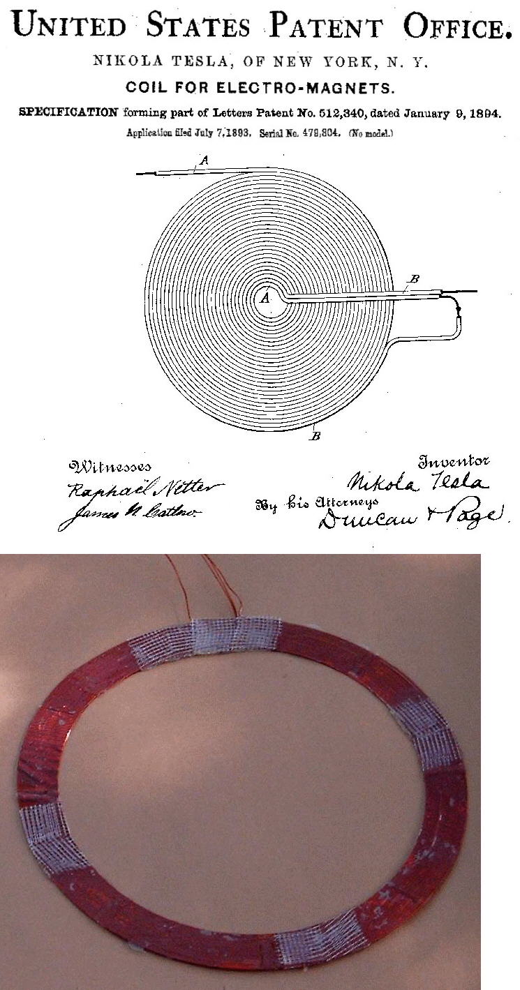

    At the Request of a guy in Slovenia, Eu. I made one of Nikola Tesla's coils in a 10 inch diameter.
    Also another in a 9 inch OD for my testing.
    Tesla, Patent number 512340, dated Jan 9 1894.
    Definately Interesting.
    I'm in the process of testing it on my PI Unit.
    If results prove bennifical, I will post further info.
    Looks like an odd way to make a double winding... don't see the advantage. :confused:
    - Carl
    P.S. -- I see you're headed for an adventure this summer!
      I wonder why he wound it so that one winding is
      90 degrees out of phase with the other? He must have had something in mind when he did it.

        I think he wound it this way to try to cut down on the capacitive coupling between turns so it would take a higher voltage without arcing over.
        Tesla used this configuration under his tower, along with a shaft going down into the ground with a tuning device, and in this position it was his earth.

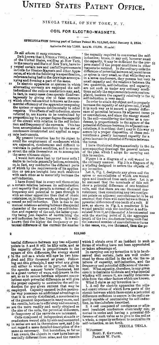

          Patent 512340, Written Portion.
          Yes Carl, The Trip Should be Interesting.
            new way?
            section 15, second column...
            "...increase the capacity of any give coil..."
            This method increase the energy stored in parassitic capacitance of any adiacent spire to obtain a lower resonance without added capacitor components.
            This effect is not the target for good PI coil.

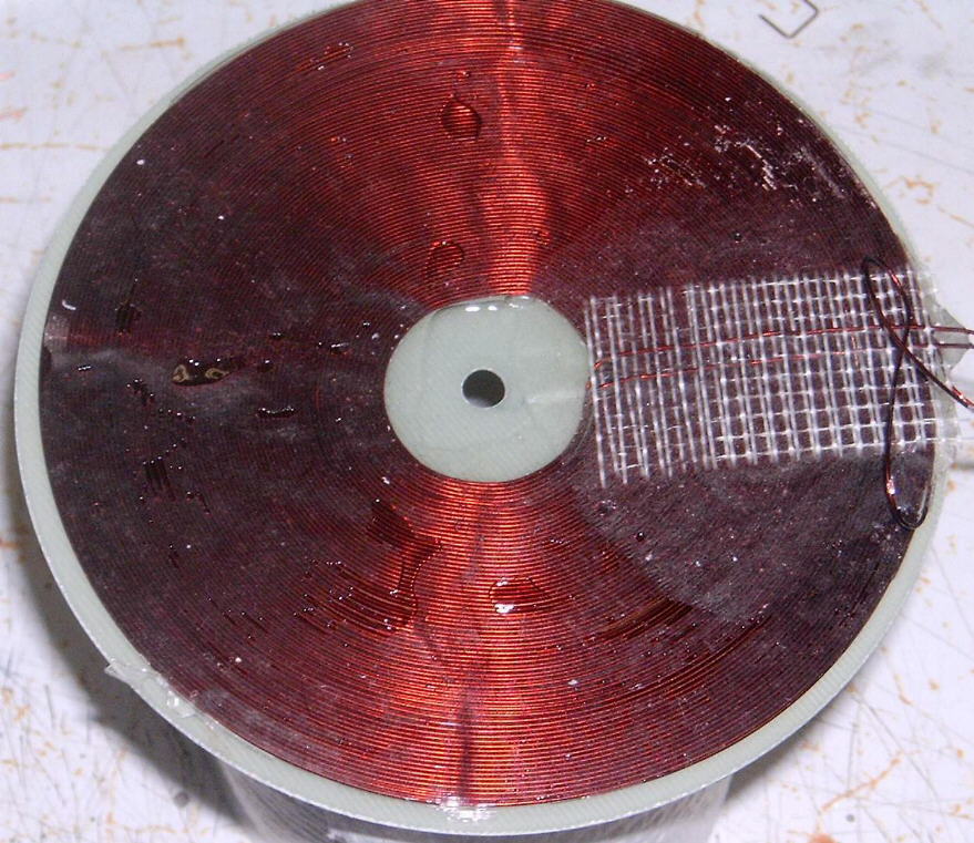

              Now as to my Two New Test Coils and my test Data.
              Both Coils are 5.125 inches ID and 7.75 Inches OD.
              Both coils Total 40 turns total.
              Both coils measure .77 Ohms.
              The Single Coil measure 405 uH
              The Tesla Dual Coil measures 407 uH
              (They were both the same inductance before applying the Epoxy, But than they both changed a bit after coating them.)
              The Single Coil has a SHARPLY Pronounced Free Air Resonance of 1.695 Mhz
              The Dual Coil has a Very SLIGHT Free Air Resonance at 240 Khz. I suspect this is due to a slight In-balance between the two opposing coils.
              These Free Air resonance tests were performed from 0 Hz, up to 2.2 Mhz. Thats the total range of "Kenwood, FG273" Function Generator.
              Using these coils on my Pulse-1 Detector, With Normal Control settings:
              Yes I Think the Dual coil is a Bit more Senstive, in Overall Performance.
              Comparing both coils on detecting a 1/2 Gram Gold Nugget, the Dual coil is Definately More Sensitive.
              Based on my test results above, I think I'm going to try to make a Smaller Tesla Coil, Simular to a 3 1/2 Inch coil that I already have.
              Comments Welcome
              Gary

                  Lots of Fun Winding these. Got it down to 2 minutes winding time for an 8 inch coil. But Gluing it is another thing.
                  MORE TO COME......Gary
                    Still Playing:
                    I wound another Tesla coil with 80 turns total, 26AWG and 3 3/4 inch Outside diameter.
                    I never designed my jig for this small of wire and this Tesla coil didn't turn out very good as some of the turns overlapped on one side, making it somewhat oval and the two coils are Not properly Equil in capacitance.
                    Winding Two Small wires simutanously is a bit tricky.
                    In any case, it detects a 0.5 gram Gold nugget at 2 inches.
                    Thats a good 1/2 inch greater than my normal coil of the same size, turns and wire gauge.
