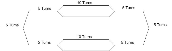

                      What about split coil windings??
                      Just a thought.
                      But what would happen if you needed lets say....30 turn coil of a certain gauge wire. You start with 5 turns of that wire then split into 2 separate wires of smaller gauge. wind this for another 5 turns and then split each of those into 4 wiresof even smaller gauge. wind for 10 turns and then split back to 2 wires for 5 more turns and then to 1 wire for the rest of the turns.
                      Like this:
                        Erm...Litz cable?? I thought this topic had been explored before, but hey, another slant on the idea.
