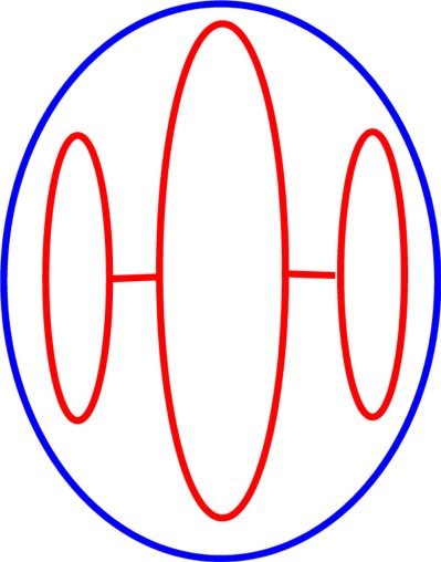

                    Hi Reg, well I'm glad to run into you again my friend. Thank you for the info on a place to get coil forms. I will check them out.Reg is the coil that has 3 receive windings a circular coplanar type or rectangular ? That must look really cool. Are you using it on the Eric Foster PI type instrument ? Are you using your coils for gold nugget hunting mostly ? How do you determine when you think you have the right thickness of aquadag on the coil ? Ok Reg I will CU later and you take care. God Bless.

                      Now, the coil is a basic coplaner design mounted in an elliptical housing. The transmit winding is like any mono type design and it fits the inside of the housing. There is one main receive running down the center and two smaller receive coils, one on each side of the main receive winding. The two smaller coils are reverse wound so they cancel the main receive coil ground signal. One can sort of think of it as a double twist figure 8 design.
                      As you might imagine, this type of design would be difficult to shield using the conventional techniques of wrapping the individual windings. In fact, just the initial layout can be a problem if certain tricks aren't used.
                      Now, here is another trick I used when trying different multiple shapes. I used velcro strips (self adhesive) type stuck to the housing and positioned such that the windings would cross the strips. Then the other half of the velcro was added to hold the windings in place. The technique worked extremely well for testing since it would allow the shapes to be modified easily.
                      Reg
                        John,
                        Here is a simple pic of the three receive coil design. I forgot to attach it to the last posting.
                        Reg

                            Hey Reg, thank you for the attached diagram and that is really cool. I know your trying to decrease ground noise but also with the extra amount of wire does that sort of provide a larger capture area for the desired signals ? Ok Reg I really thank you for the trouble your going to but I bet a lot of lookers like it too. Ok I will see if I can find another question and chat with you soon. God Bless.
                            John Tomlinson, CET
                              Hi John,
                              The 3 coil design both ground cancels and noise cancels so it is very quiet when the receive coils are properly adjusted. The down side is some ultimate depth loss when compared to a mono coil operating under idea conditions.
                              Now, this design of a coil would work well on a PI that has no ground balance and in many places would provide improved depth. So, there is an advantage to such a design in some locations.
                              One way to make such a design is to simply calculate the total size of the three coils and make one large coil a little larger than twice the size of the center receive coil. Then the large coil is divided into the three by a half twist on each side. The result is the three coils.
                              Now, the basic sizing is such that the sum of the area of the two side coils about equals the main center detection coil. So, the initial layout is reasonably simple. From there it is just a matter of minor adjustments to coil sizes.
                              If the secondary coils are too large then you get sort of a reverse ground signal, so it is easy to figure out just what needs to be done. By using the technique I mentioned earlier of using Velcro to hold the coils in place, the final sizing and shape is a simple and quick process. If the housings already have shielding then once the coils are correctly aligned, they can be glued in place using one of several methods.
                              The idea of a coil on each side is to reduce any dramatic ground signal change should the coil be tilted sideways.
                              Now, as I mentioned before, this type of design works best if the shielding is done using paint, rather than applying a tape to the windings.
