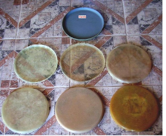

    Has anyone tried fiberglass coil housing? Her some, a man who built boats make for me from a matrix:
    i use fiberglass for the stick light and very cheap and hard
      I have always used fiberglass for the housings but can easily wear thru a fiberglass bottom in two days if looking for nuggets. Probably ok for the beach or most relic hunting though. I had to resort to plastic for the skid plates.
      Rob.
        Hi Esteban. It seem to be polyester not fiberglass. If i remember right the polyester is not good for coil housing
          I've done some 28sm and 35sm coils, here are 28sm:
