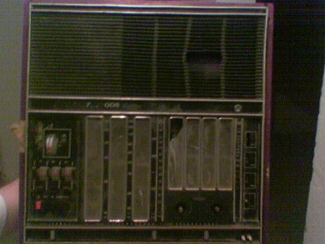

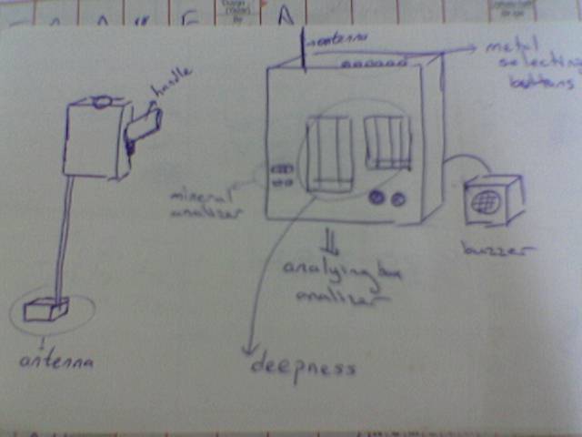

                Hi Qiaozhi,
                indeed, I want to build something like my father's friend's old detector which was stolen during earthquake in 1999.
                I know you wont believe but my father and hiz friend found a gold coin in a small(fist size)closed cup which was at almost 4 meters dept.
                I am trying to solve it's system.it was something from 1975's.
                it head(where transmitter and reciever are) was soo small .something like 3cm*8cm*12cm
                according to told me by owner, 3 or 4 coils inside.
                first was on iron core(inside empty like pipe)
                second was around it like ( look at carl's BFO theory file.first like figure 3 ,second like the figure figure 4.b
                http://www.thunting.com/geotech/page...theory/bfo.pdf
                these two in same plain(propagateing same direction.(down to ground)
                third is on u core ,and winded perpendecular to first group.
                do not know working frequency.
                and while these two perpendecular groups too close (opposed to TR (two box)detectors) how can it detect from 4 meters
                thanks

                  This does not look like a BFO design to me. Firstly there is more than one coil in the search head, so it is possibly some sort of induction balance design. Have a look at Carl's latest coil article, in particular figure 4.
                  http://www.thunting.com/geotech/page...info/coils.pdf
                  This uses orthogonal coils in a similar manner to a 2-box detector, but they are in close proximity to each other. Of course, finding a gold coin in a jar at 4 metres could just be a lucky coincidence. You can only really believe such a claim if it is repeatable.

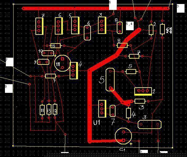

                        Hi Qiaozhi
                        if I can draw schematic ,could you understand it type .
                          Hi Qiaozhi
                          OK - please post the schematic. I will be more than happy to take a look.
                            hi
                              hi
                              I tried to show wire connections with yellow lines.and numbers that are written on board.
                              I thought you could understand from shapes ,so just written numbers of components.
                              I directly copied board .because of that some numbers are not used.
                              capasitor
                              c1 10uF
                              c3 68n
                              c5 68n
                              c6 47n
                              c7,c9,c10,c8 = measured value changes bwtween 2.8 -3 pF
                              c11 10uF
                              UT1=UT2=UT3
                              UT4=UT5=UT6=UT7
                              resistors
                              r3,r8 10k
                              r10,r9 1k5
                              r1,r2 3k
                              r7 (100P) = 1k
                              r5,r4,r11,r12 100k
                              r13 100 ohm
