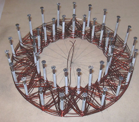

    Please could you help me.How can I make discrimination of Clone PI.
    How can I must use coil.Could you show photo of the coil.Thank you for your helping.Regards.

        coil

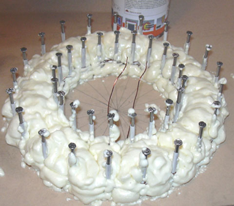

        Hello.I thing must use this coil for clone PI Discriminate.Is it right.Thank you for your helping.

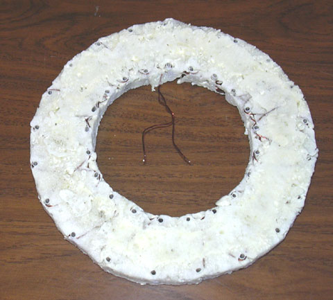

          coil

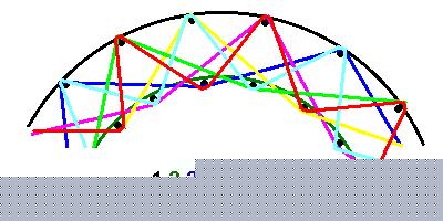

          coil 2.

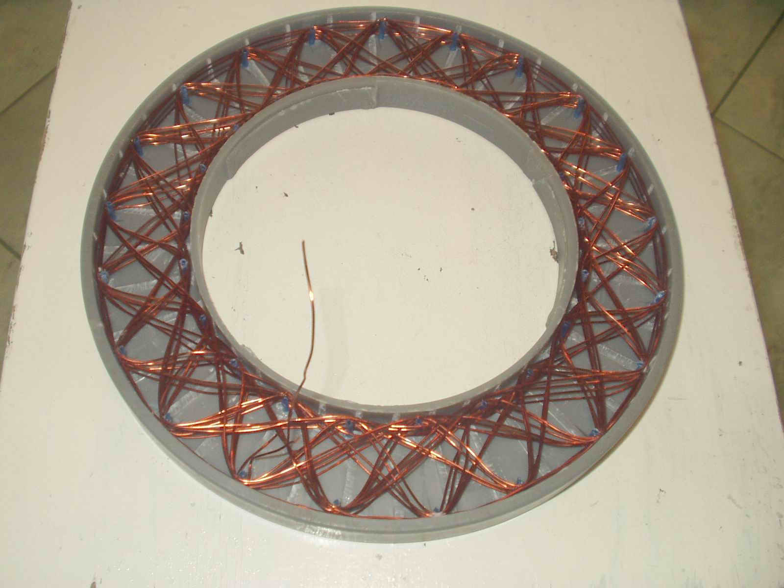

            coil
            coil 3 - 4.
              is this basket coil
                JAJAJA
                Is a CAKE coil ???

                      What is this type of coil (really) called and where can I read about the theory behind constructing it in this manner?
                        theory is more in radio engineering field, in antennas' application etc. not in metaldetecting area. there maybe exist much winding ways, what you see here is only one from dozen.
