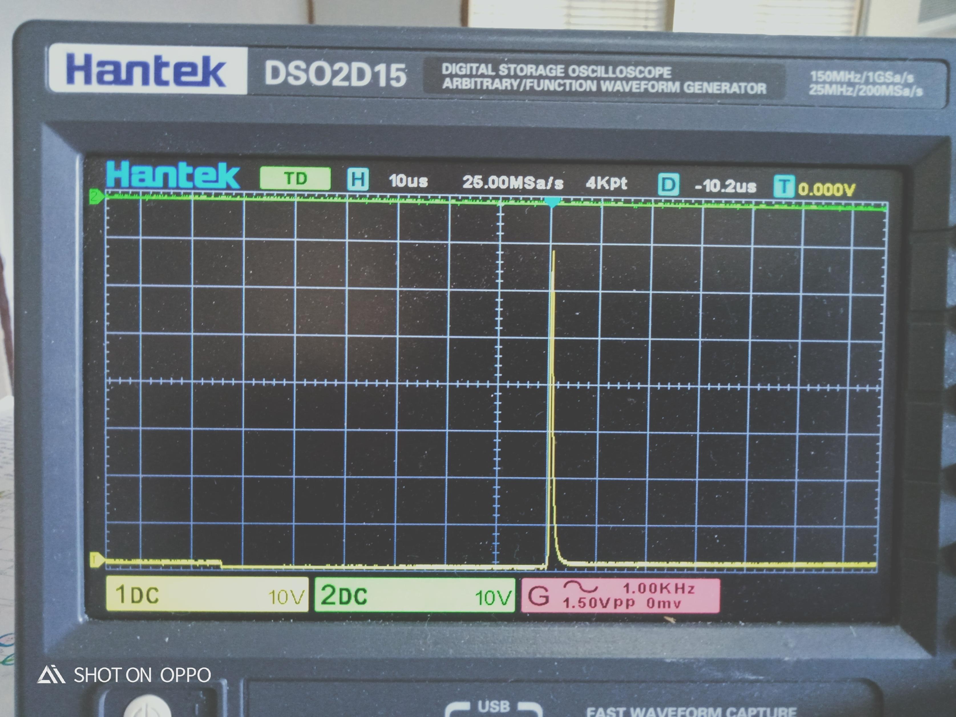

                      Hello Carl,
                      Do you by chance recall the type of conductive tape? Was it a fabric or copper type?
                        I am still very much in the experimental stages of PI detectors, but my pulse times appear to be short.
                        At this time I am using a parallel wire twin similar to 300 ohm tv ribbon wrapped around the shaft. If this is balanced ie equal turns around the shaft is it a viable option or will earth field, radio etc interfere with it?
                        I am using a 280mm Click image for larger version
Name:	flyback pulse .jpg
ID:	408522 300uH coil made from recycled cat5 wire with a 3mm spaced foam shield and wrapped with a strip of emi interference cloth.
                        Steve
                          It's the same stuff mentioned on a lot of threads here, 3M 2191FR or equivalent. Off-brand is cheaper and easily found on Amazon, eBay, and AliExpress. Search for "Faraday tape" with maybe 'fabric' and 'nickel'.
                            300 ohms will have low capacitance (good) but without any shielding may be more susceptible to EMI.
