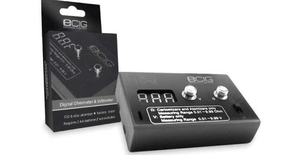

          Im measuring the resistance of the coils using this little tool..
          eCig Digital Ohmmeter & Voltmeter. Standard Configuration: 1× Meter Device, 1x ConnectorTested Resistance: 0.01 ohm ~ 9.99 ohmTested Voltage: 0.01 V ~ 9.99 VOperating voltage: 2.2V to 5.5V

            Thank you carl inuse chinesse tansistor tester​ t7 my be it has auto frequency 1 khz .
