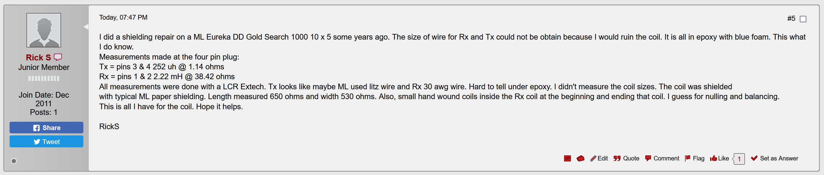

    can anyone tell me the coil inductance & resistance of the Eureka ?
    i would like to build a concentric coil for it.
    please could any one help .. concentric coil for eureka .... inductance, resistance and capacitors.

          I apologize, but I had to do a restore on the forum database and lost the last two posts to this thread. I did an image capture on them first and am posting them here:

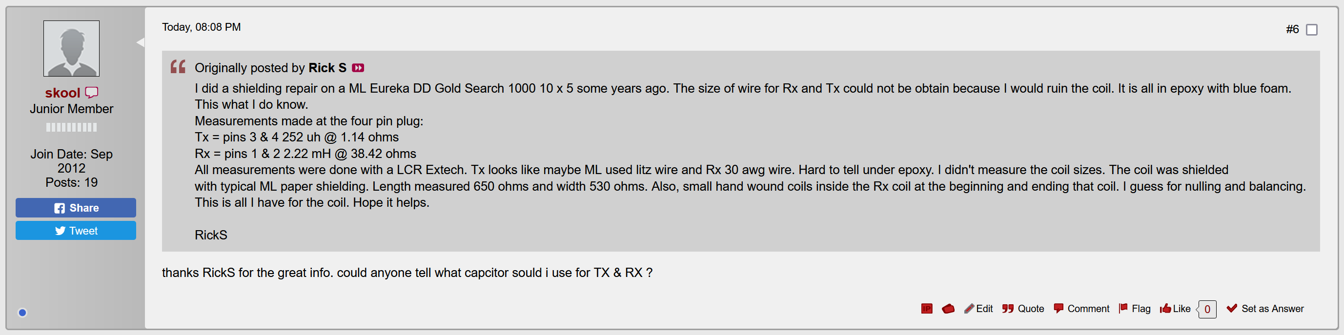

            according to the TX & RX inductance and resistance of the eureka coil how the capacitor value is determined ?
              The Eureka runs at 3 frequencies so either there are 3 caps that get switched in or it runs with a square-wave drive. If caps are used they can be calculated by
                thanks Carl
