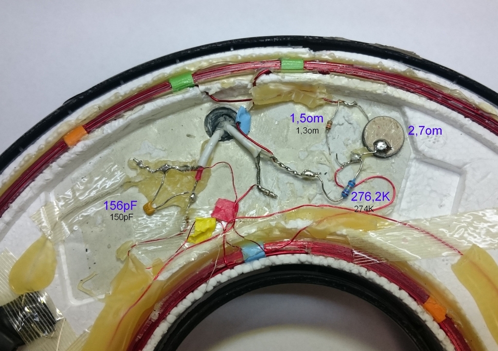

    Im trying building a DD coil for Whites spectra/dfx etc
    The winding it self are very close to original but the coil is not working correctly.
    I find out (on this forum) that there are resistors and capacitors connected within the coil as well. (i did not have them in the coil that i build.)
    I found this picture from the attachment
    https://www.geotech1.com/forums/file...1&d=1446770951
    But this is a concentric coil, im hoping that someone can help me out with how to add the capacitors and resistors on my DD coil.

    I believe those components were needed to dial in the null at 15kHz. You should not need them for DD.

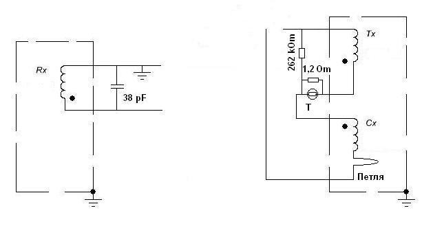

            Thanks for the reply, when i read the schematic above correct this one is for the concentric coil. How should i apply this to a DD coil?
            Add a capacitor from 38Pf between RX + and RX -? What about the TX side?
              The 38pF cap on the RX coil is probably to suppress fast transients. It should be less necessary on a DD coil but you can try it.
              On the TX side there is a thermistor (PTC, probably 3900ppm/°C) to cancel the temperature drift of the coil. I don't know the value. It is mostly needed in manual ground balance mode, autotrack should otherwise deal with coil drift.
              You never stated what the problem was with the coil. These extra components are for 2nd order effects and I would not expect them to make a non-working coil start working.
                        at first picture 150 pF, 38 pF is sure mistake, very low.
                        at first picture its value noted as 2.7 Ohm., in room temperature. negative temperature Coefficient electric resistance​
                          I'm sorry, the copper wire is PTC, the thermistor needs to be NTC.
