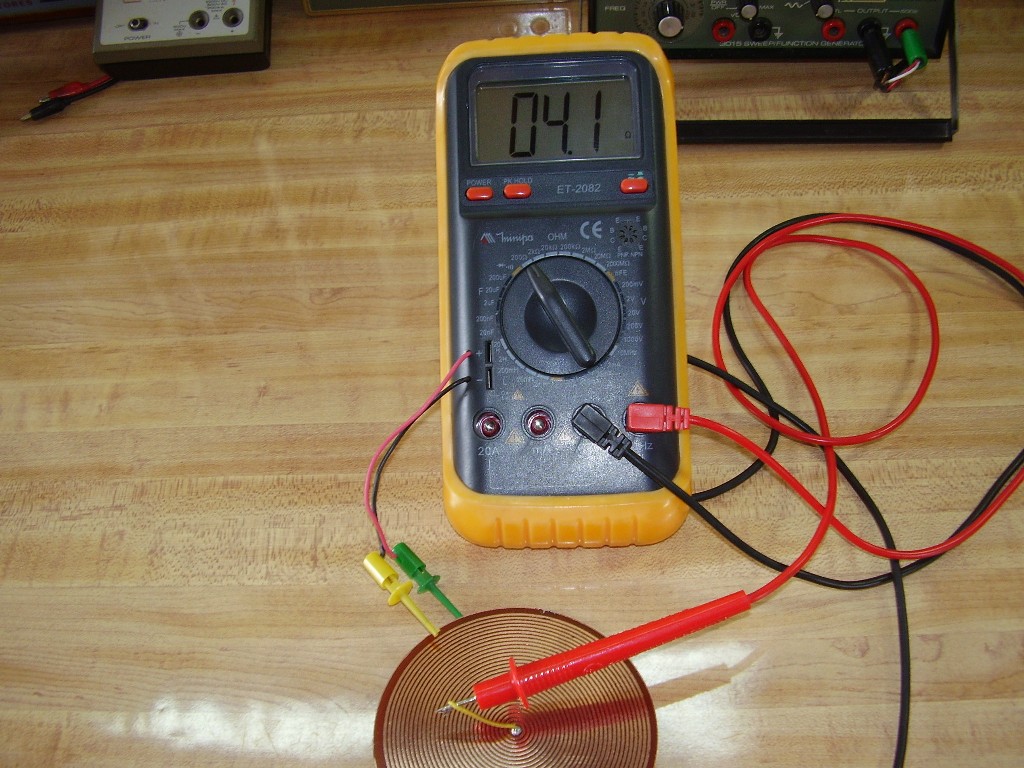

            Yes, this is a 4 ohm coil! :mad:

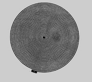

            I copy this over copper via film technic. I found in a magazine. Was many years ago.

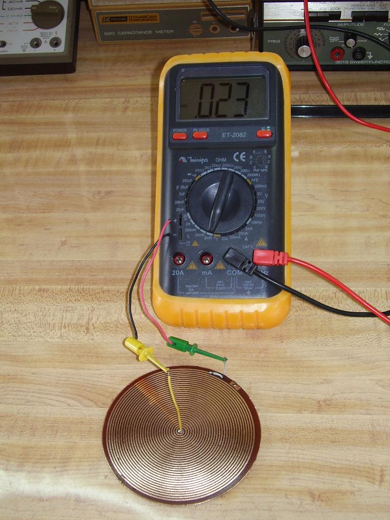

              And What was the Inductance?
                I'll measure and post it.
                  Taking a Wild Guess from the looks of it I would say about 120uH at most.
                    This coil is 9.5 cm diam, 30 turns + center point (decreasing in diameter, of course), each turn wide 1 mm and spaced 0.85 mm, resistence 4.1 - 0.2 (this is cable's resistance of tester) = 3.9 ohms, inductance shows here .023 mH = 23 uH, but no contrasted with other instrument.
                    I'll post photos of the film (no find at this moment yet!) and original photo in magazine. This coil was designed for wideband electromagnetotherapy.

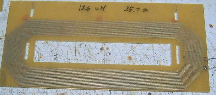

                          Here is one PCB coil that I have on hand.
                          This one was done by a friend of mine on 1 ounce pcb. It measures 7.75 inches by 2.875 inches.
                          It has an Inductance of 126uH and a DC Resistance of 25.77 Ohms.
                          Even if it was done with 2 Ounce copper and Tin Plated, it would Still be about 12 Ohms.
