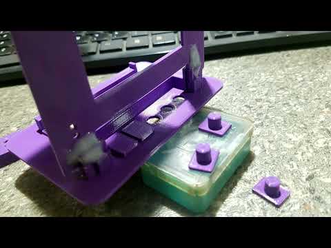

                            Keep in mind that many filaments are hydroscopic and absorb water over time. There is a guy on youtube who makes 3D printed submarines who did a video on waterproofing them. Basically, even if you print a coil housing with 100% infill, the PLA will eventually absorb water and it will end up seeping inside the coil. He shows how he waterproofed it to keep water out. I don't know if ASX or ABS are similar. You would want to check this if you want to use these coils in wet situations.
                            https://www.youtube.com/watch?v=Q8x-mjjT8j4
