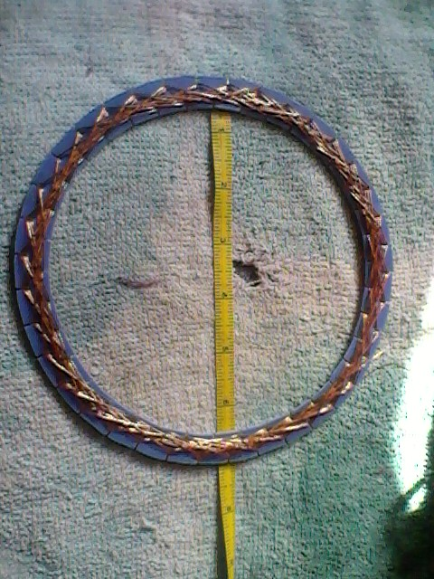

      A quick google search brought up this
      which is just like the one I made.

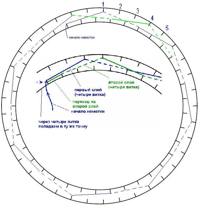

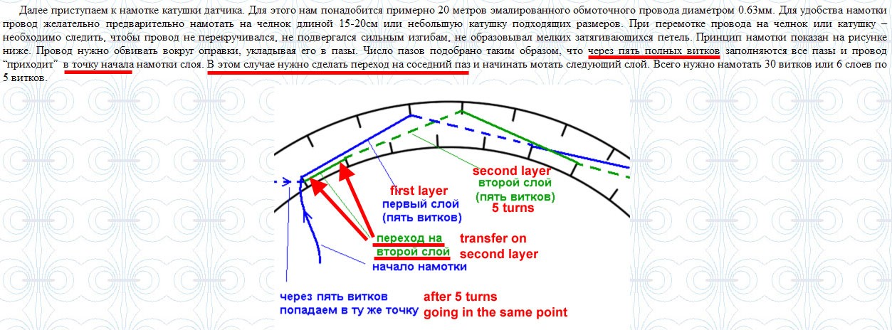

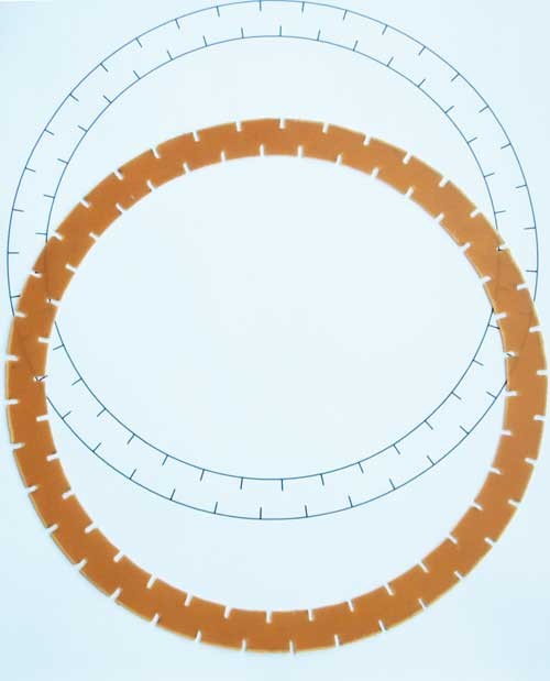

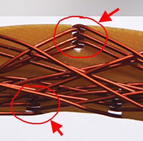

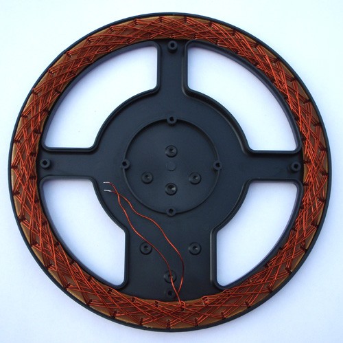

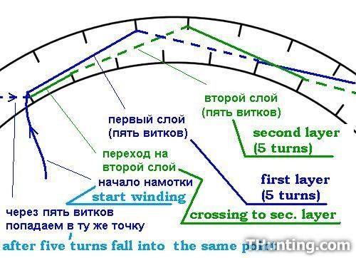

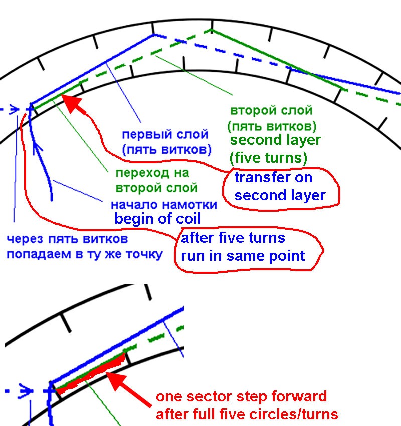

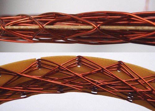

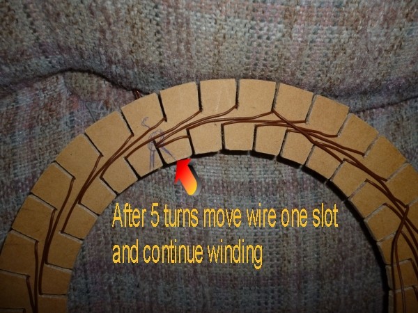

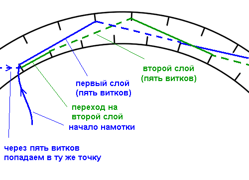

        just reminder you have to do the coil right. much people of the forum got mistakes winding this type of coil with poor result. Click image for larger version

            The intercoil parasitic capacitance of the coil can be greatly reduced not only by this complicated way of winding, but also very simply by winding it not with enameled wire, but with PVC-insulated wire. The distance between the wires will be larger and the interwinding capacitance will be smaller.
