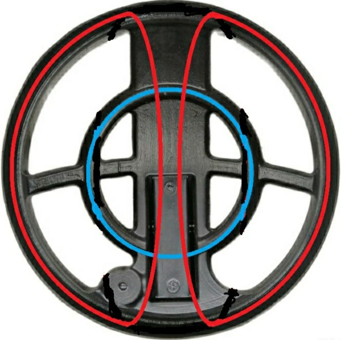

          Cast. I assumed as much. And what do you say about such a differential sensor? The blue coil is TH, the two red coils are RH. The inclusion of the PX coils is done in such a way that in the "common zone" the currents are directed in one direction. Click image for larger version
            It'll probably work, but when the TX is smaller than the RX you can get some strange target responses. I don't know what you mean by "PX" coils.
              I apologize. By the РХ=RХ coil, I mean the receiving coil (RX).
