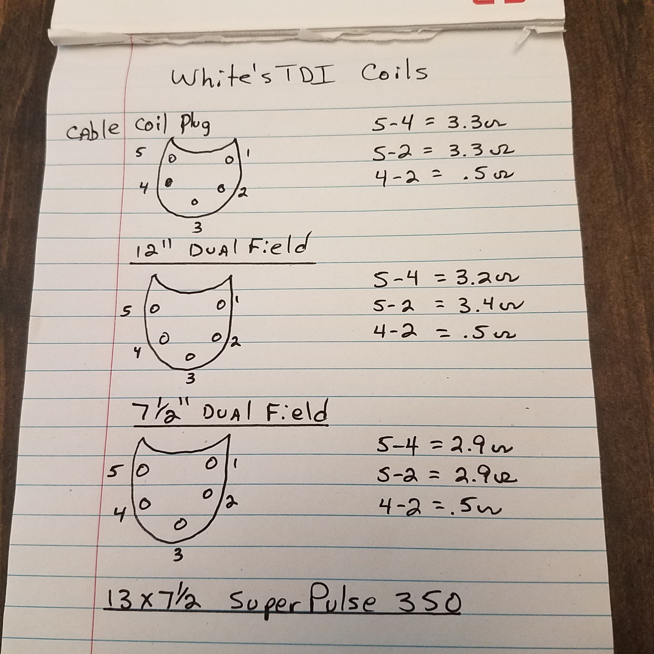

    The following are the ohm readings I have. That said all 3 coils might be a dual scan.
    "This time I don't remember the resistance of coils but the inductance of outside coil is 230uH and from the inner is 65 uh. Total inductance is 360uh (meter reading but I suppose that it is near to 330uh). Parallel to small (inner) coil there is a resistance 4K7. Outer coil has 22 turns and inner has 19 turns (maybe to have an error of 1 turn)."
        I don't have any reading on my pin 1. There may not be anyway of knowing what the coil truly is.
