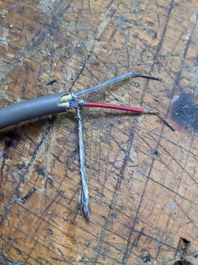

    I bought a White's DFX for parts, but I thought I might try repairing it to learn a few things before it meets its fate. The previous owner got it a little too close to the Gulf Of Mexico, and it has obvious signs of some saltwater intrusion. I thought I could easily remove the corroded 5-Pin connector and solder on a new one, but it seems not that easy. The connector end of the coil cable took on saltwater, which wicked into both the spiral shield and the center conductor of both coaxial cables. The corrosion on the wires is preventing me from making reliable solder joints. I've cut back around 8 inches and it's just more of the same. What is the general wisdom with re-cabling a coil? Is the original style dual coaxial cable available somewhere, or is it just as well to use microphone cable, which uses one shield surrounding both conductors?

              kt315, here's a picture for reference. The coaxial wire seems like it has teflon around the center conductor, then a spiral shield and a jacket over that. The jacket enclosing both coaxial wires also seems to have a support of polypropylene or something similar, which is not visible as I had already cut it back before I took the picture.

                thank you for pic. dual/double/twin coaxial/coax, but with multistrand central wires. i will look in a cataloque but it is old.
                as a simplest way you may take two coax and put them in thermotube.

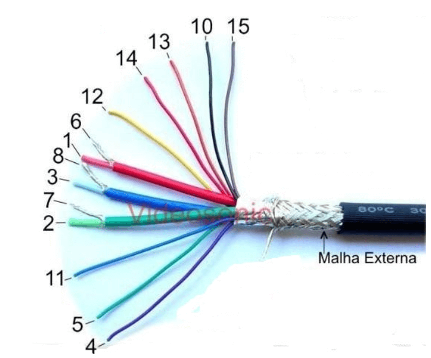

                    i suggest to people to seek out VGA-SVGA monitor cable. they are due trashboxed and everyone can take them much around.
                    this type of cable has all variations of using - from ordinary PI to complex VLF coil with the preamplifier with outer voltage DC supply.
                    it has - three hoax, for R G B, etc.
                    https://monitor4ik.com/wp-content/up...19/03/Scr1.pngClick image for larger version  Name:	Scr1.png Views:	0 Size:	114.7 KB ID:	413702
                      kt315, thanks for the picture of the SVGA cable. It seems like a great idea too! Would all those extra conductors need to be attached to ground? I didn't know if they could all act as little antennae for EMI.

                          This cable is not suitable for mechanical and temperature properties. The central veins of the coax are very thin and break. Waste of time and nerves afterwards.
