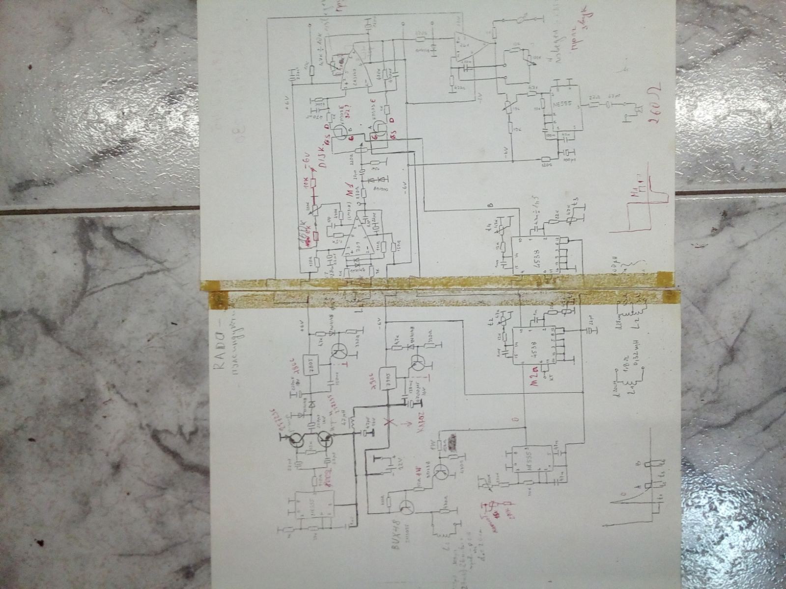

    what for resist shold a PI coil have? have wire 2 coils arround 330uH 0.4wire 0.6
    0.4 2.5ohm
    0.6 1ohm

                    it was more a general question. btw i forgott to tell the coil are simple round shape 280mm
