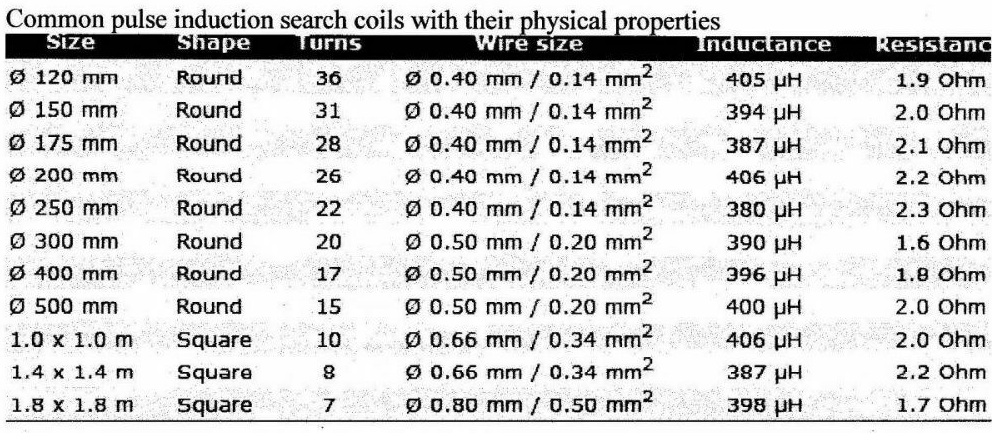

    Does anyone here has measured the Pirat metal detector coil, I would like to know the inductance and the Q you have found at about 120Hz?
    I have a couple of coils that have, not sure if they are fine to be used with a Pirat:
    1: 369uH / Q = 0.173 / Dia: 26mm / R = 1.6Ohms
    2: 378uH / Q = 0.196 / Dia: 15 cm / R = 1.45 Ohms
    Here is a list of coil parameter which you can use with the Prirate PI detector.
Name:	Pirate PI MTX Version(6) Coil Specifications.png
      Q values are not listed here...

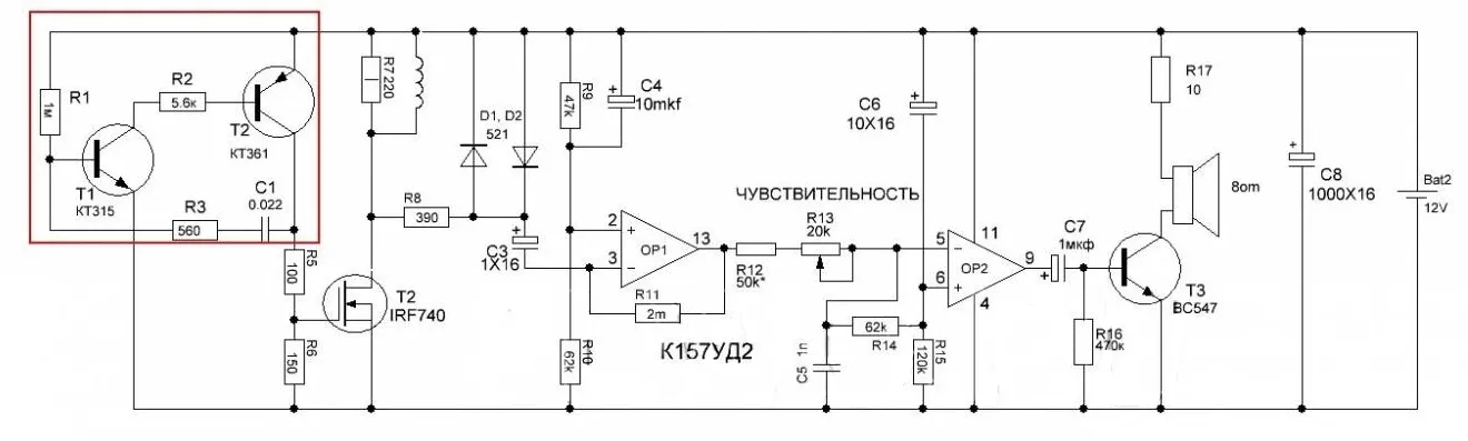

                    Hi KT315,
                    thanks for letting us know. I found this on the Internet. So is this the original Pirate PI schematic?
Name:	Pirate PI (Безымянный).webp
                      hi amigo
                      i do not follow this project, not my matter, but in first circuit was set NE555 like TX generator. anyway, you can read this russian forum and to seek every step of the mods.
                      step-by-step.
                      Импульсник с амплитудным детектором (ИМПАД, позже - "Пират") - Page 30 - Металлоискатели - Форум по радиоэлектронике (cxem.net)
                      Пират на SMD без К157УД - Просмотр темы • Схемы металлоискателей MD4U •​​

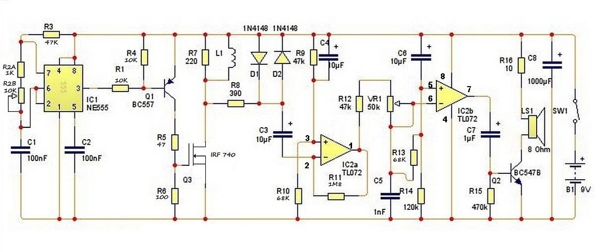

                            the schematic I upload was an old schematic with the Russian IC (K157UD2). I only asked KT315 whether this one was the original Pirate PI detector schematic. There are other schematics with the TL072 and NE555 timer available. Like this one...

                              as a starter you can make a Pirate PI detector and learn from it first. It is easy to do. But if you want to make a good detector, I would recommend you to make either the Surf PI, MiniPulse Hammerhead or Baraccuda detector. These projects are very good documented on Geotech Forum and there are also video tutorials on Youtube available. Just google it.
