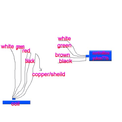

carl? I know ya can help me put my coil back on my compass
  • carl? I know ya can help me put my coil back on my compass
    once upon a time, I cut my wires off my coil and controll houseing and since then I lost the little connector in the middle, since then.
    inside of my box is 4 wires comeing from the motherboard.
    on my origional coil is 5 wires.
    6 if you count the alumininum mylar type sheilding
    do you know this machine? and the coil ?
    compass yukon 771b or is it ib?
    any ways I need to know the exact order one again that the coil wires go to the controll box.
    can you help me with maybe a simple schamatic of the wire arangements?
    I can send pic's of what I have, if you need.
    I miss this old unit working.
    it's the older compass 77ib with the rocker switch to turn it on 3 pole, 3 throw, shaped sorta like this--> _☻_
    thanks carl for any help and try to get back to me
    coil #2 diagram I have
    this is sorta what I got.
    kinda confuseing.
    can ya tell which wire goes where?
      Willrich,
      Here is an "educated" guess.
      The black and shield wires are connected together on the coil-side and connect to the black wire on the detector-side. The assumption here is that these leads or wires are "ground". You can connect one lead of a multimeter to ground or chassis of the Yukon, and the other lead to the black wire coming out of the Yukon, if the above assumption is correct, you should see a short or zero ohms.
      Red sometimes looks like brown, this is often due to the color fading from exposure to heat [sun light], or chemical reactions. So it is likely that the red on the coil-side connects to the brown on the detector-side. In any case by process of elimination the red and brown wires are the only ones left over based on the first paragraph, so they most likely connect to each other.
      Coil <--> Detector
      white <--> white
      green
      <--> green
      red
      <--> brown
      black/shield
      <--> black
      Again, the above is an educated guess.
      Andy
