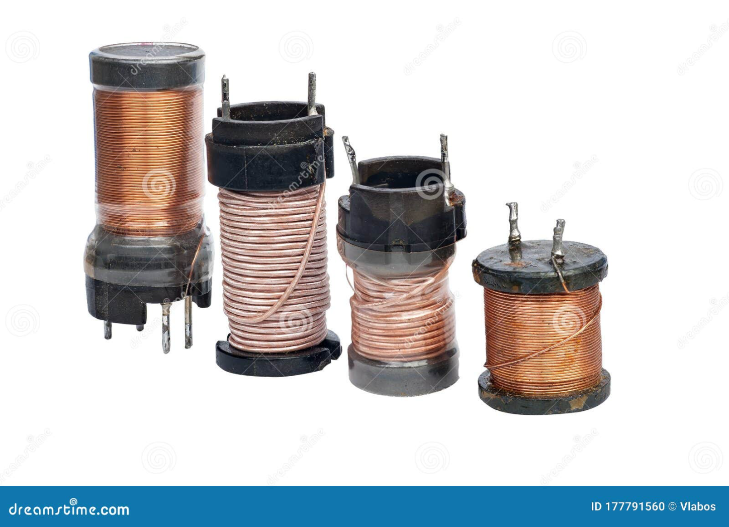

              and possible sense the wiring layout. = You can trace Tx coil shape without X ray, just use small pickup coil ( inductor with ferrite core )

                      I used a 900uH small flat wound RF choke as a pick-up loop for the O-scope. I placed 91 kHz on the coil loop leads at about 0 dBm, 135 Ohms Z. The mono coils only show signal only around the perimeters, for both coils on the connector. The 13" DD coil is indeed a DD configuration. It appears that the two coils on the connector, Pins 1/2 and 3/4 are wound on the same perimeter or DD layout. I must have been detecting shielding with the pin-pointer.
