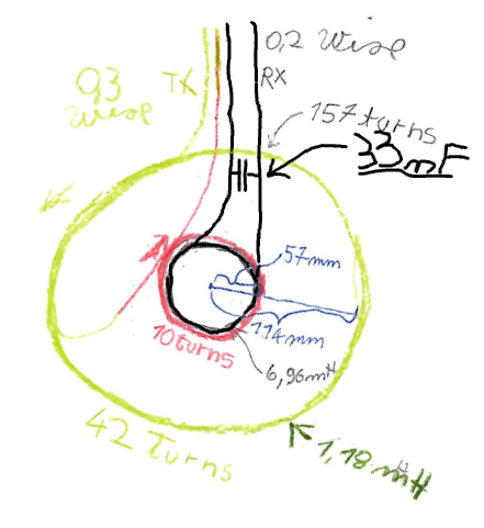

                      Hello
                      I calculated a coil, but i don´t know if it will work. It would very nice if somebody could control my calculations.
                      the tx(+bx) coil have a inductance of 1.18 mH and is wound with 0.3 mm wire.
                      the rx coil is wound with 0.2 wire and have a inductance of 6.96 mH

                      In the end I have a few questions:
                      do I need any capicators in this coil, if yes, where they are needed?
                      could you null a coil, by connecting an AC voltage source to tx, measuring the voltage applied to rx, and then continuing to wind bx until no voltage is applied to rx?

                            Offhand, it looks reasonable. I might add 1 or 2 extra BX turns just to be safe, then peel them off if not needed. Yes, you can wind the BX coil while watching the RX signal.
                            If this coil is for Voodoo, then the RX coil needs a cap. The book explains what value. You can put it in the coil or in the circuit.

                              itś right so?
