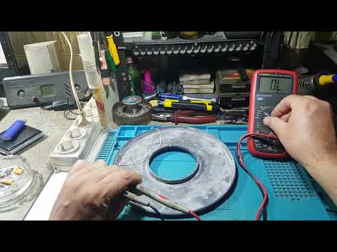

    Accidental discovery... not sure how it will turn out in coil shielding...
    Tape thickness is 0.019mm.
    The tape is very strong and will not suffer any damage while wrapping around the coil.
    I haven't tried it yet... is this even worth trying?
    I have "miles" of this tape in my attic!

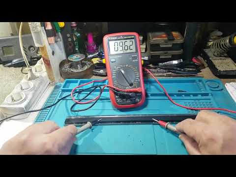

      If that's really megohms, then no, too high.
        Yes it is.
        Guess what the tape it is?
        VHS tape!
          Second, it is "conductive" only on the "inner" (bottom) side and not the other way around.
          Once, I ran unimer probes over the black epoxy on a Fisher coil and once over the black coating inside the White's coil.
          With the Fisher coil (Quicksilver), the resistance was consistently around 2 megohms, no matter how far the unimer probes were from each other.
          I can't remember about White's, but I think there was a lot of resistance as well.
          The magnetic layer on the lower part of this tape first associated me with a similar material that is mixed with epoxy with which the coils are filled.

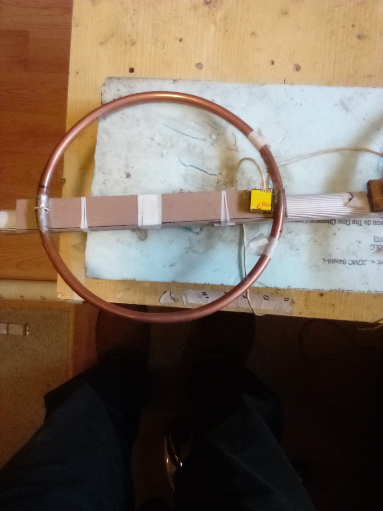

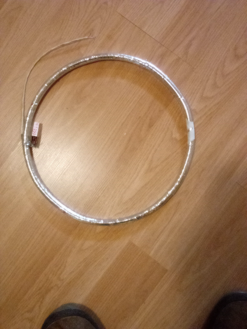

                              Click image for larger version  Name:	image.png Views:	0 Size:	1.02 MB ID:	422712​Click image for larger version  Name:	image.png Views:	0 Size:	1.05 MB ID:	422713​

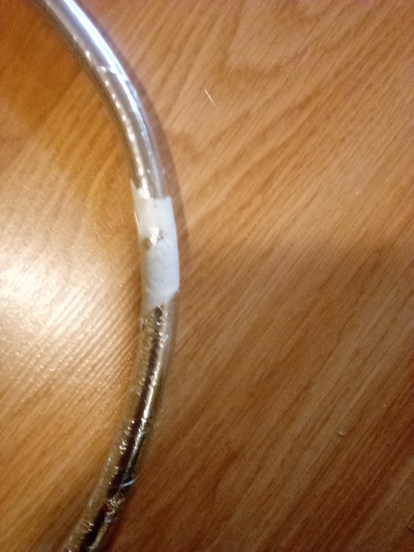

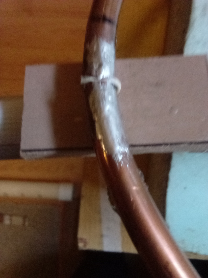

                              overlapping
