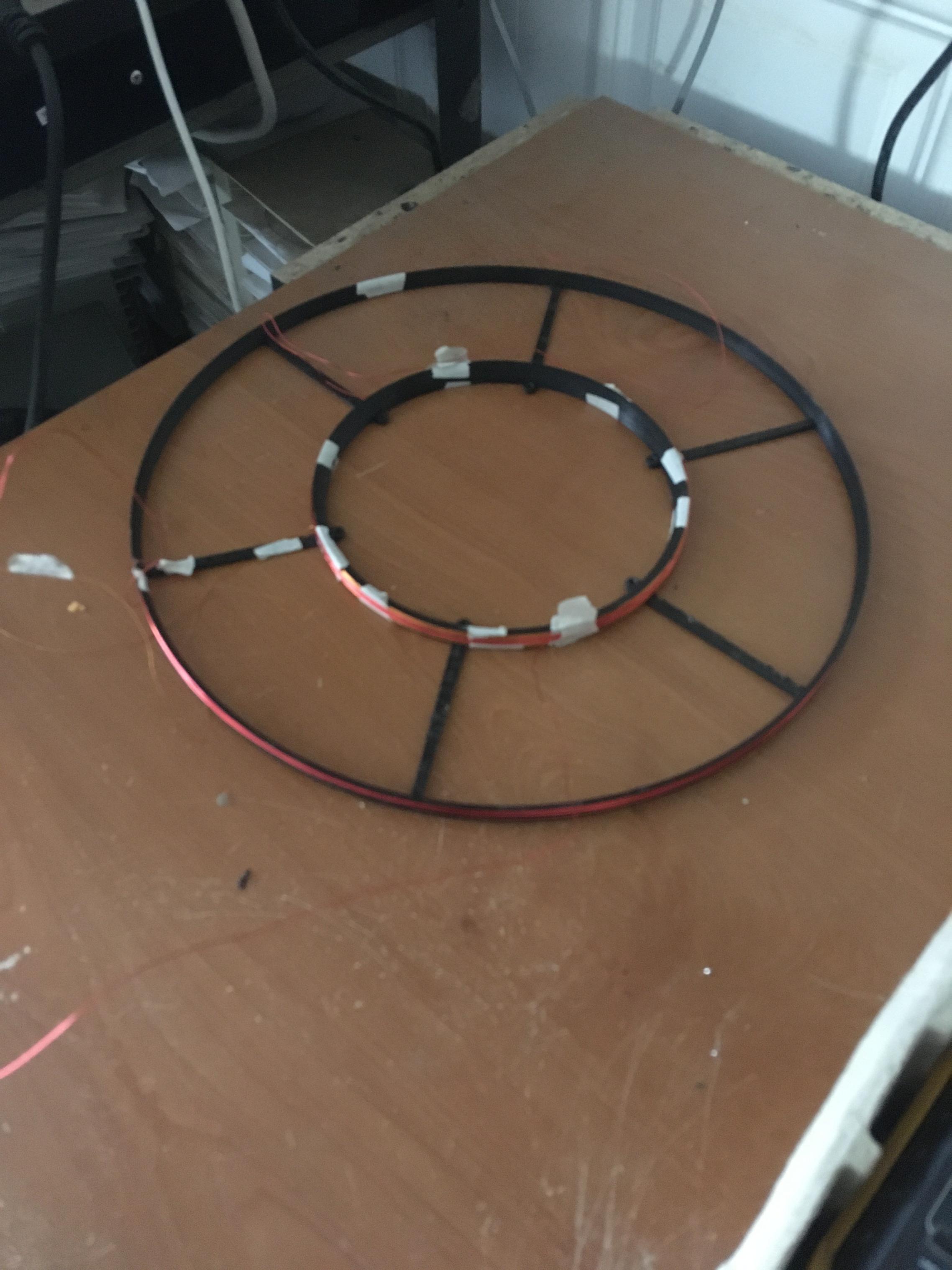

    I have been struggling making a couple coils including one that has the wind numbers and guages from Don and ALL the coils resistance are lower than they should be. I suspect the motor wire I bought from crappy Amazon is not pure copper. This is causing huge headaches for me.
    Anyone recommendations for wire brands, sources?

                            Pic of core I am using to wind the copper on my winding machine. I will later make a housing this will be epoxied into.
                            Think I found another brand and they indicate the wire is pure copper so will buy new spools. I posted the specs on another topic and this is for a delta pin Tesoro.
                            Of the 3 coils I tried to make including Don Bowers all were epic fails as the winds needed were no were close to the specs they should be and why I questioned the wire itself.
                            Will let you guys know how it goes.

                              What were the specs, and what were the results? What diameter, number of turns, and gauge of wire? Even if the wire has a higher resistivity the inductance should be good, and the coil will likely work just fine.
