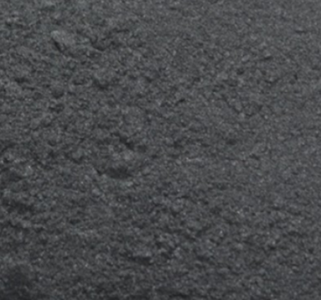

        Have you ever seen a woman's face powder? This is the same size of graphite.
          Originally posted by Daves View Post
          In another way, the size of graphite can be described as a toner for a laser printer

                I bought 99% pure graphite powder. I will try mixing this with sodium silicate.
                As the second method, I bought transparent varnish and will mix it with graphite and try it.
                I will prepare it as 1:1 or 1:2 and try it. If I see a value between 1k and 10k ohms when I measure at 1cm intervals, I think it is good, what do you think? If I see 30,40k I will try adding more sodium silicate or varnish to thin the shield. If I see around 500ohms I will experiment with adding more graphite.

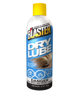

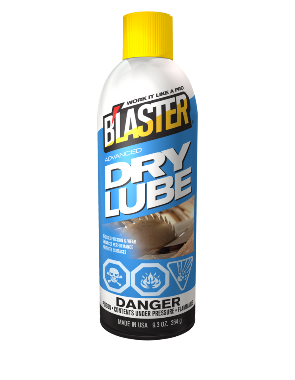

                    try graphite dry lubricant spray, resistance not critical, about 2k.
