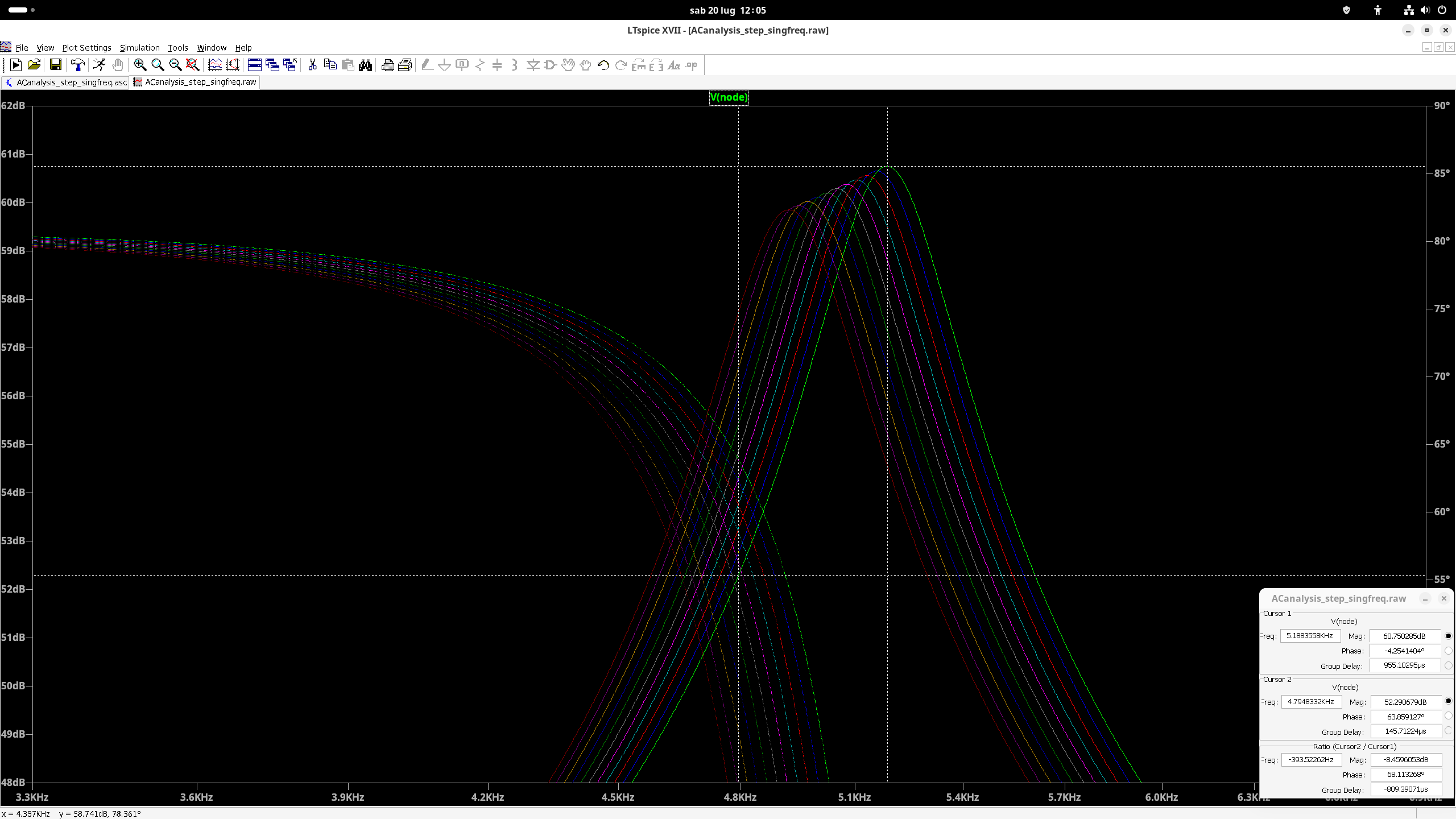

                yes, I would like to build “a detector”. It's actually already finished. The problem is not really the coil. It's the detector and the coil together. The detector has a quartz oscillator and the square wave signal is transferred to the TX coil via a level converter. The resonant frequency must therefore be just as correct as the winding resistance. +/- a few 100 milliohms. Otherwise the power / the current​... is missing or the signal is distorted.
                However, I have now simulated both oscillator circuits in LT spice using the values in this “found” list. I think it should fit.
                Thanks again.
                  The resonant frequency = can be corrected by changing the value of capacitor (s)
                  to adopt your coil, show the schematic

                    hello, thank you for your inspirational help.
                    I think I have solved the problem in the meantime. The values from the list seem to fit the 1266. They even seem to be pretty accurate. I have a 77.5 Khz and a 153.6 Khz crystal available. Divided by 1:16 and 1:32 respectively, I should be able to match the resonant frequency of the coil pretty well in both cases. I can then compensate for the remaining small inaccuracy with a capacitor.

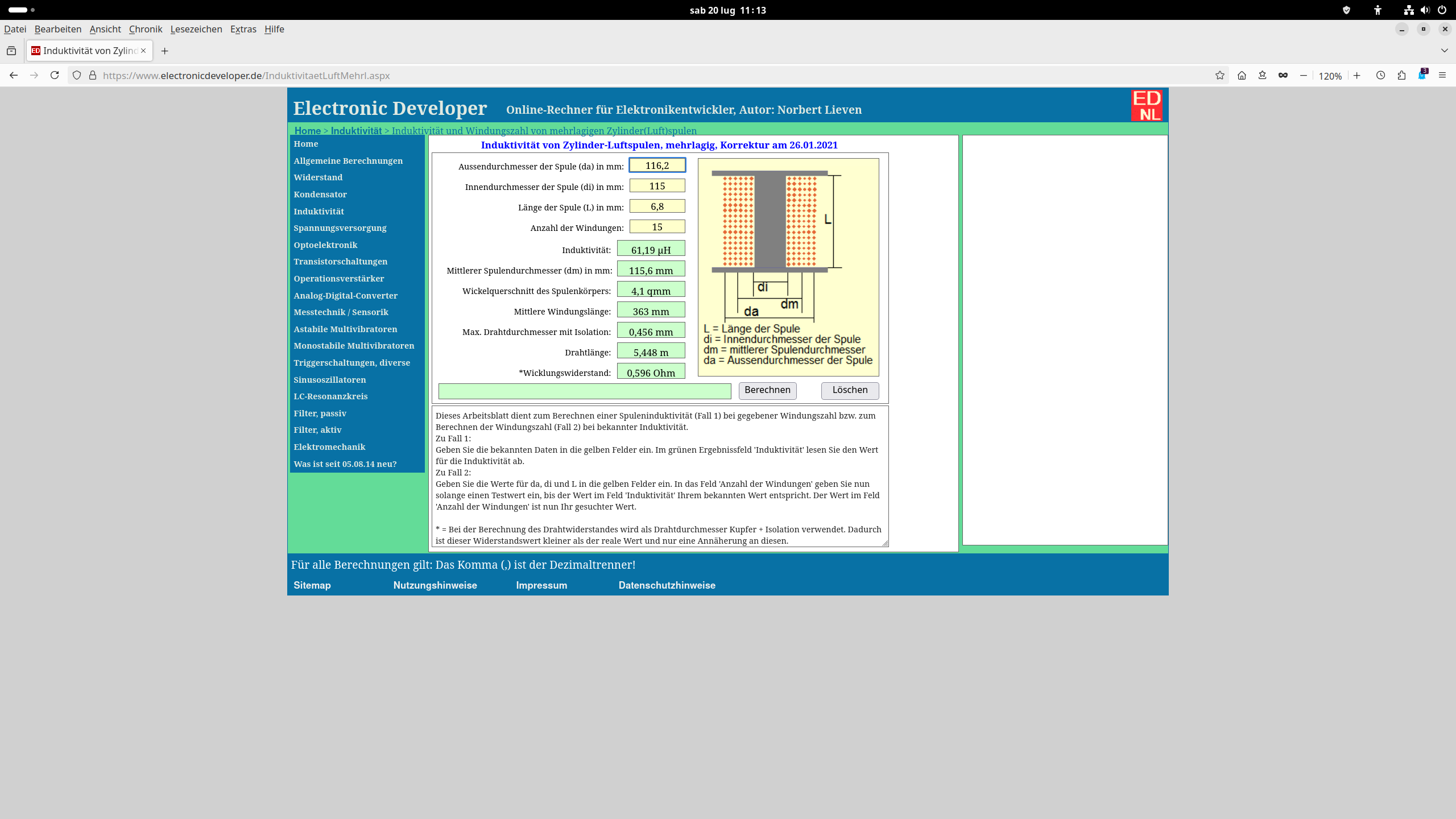

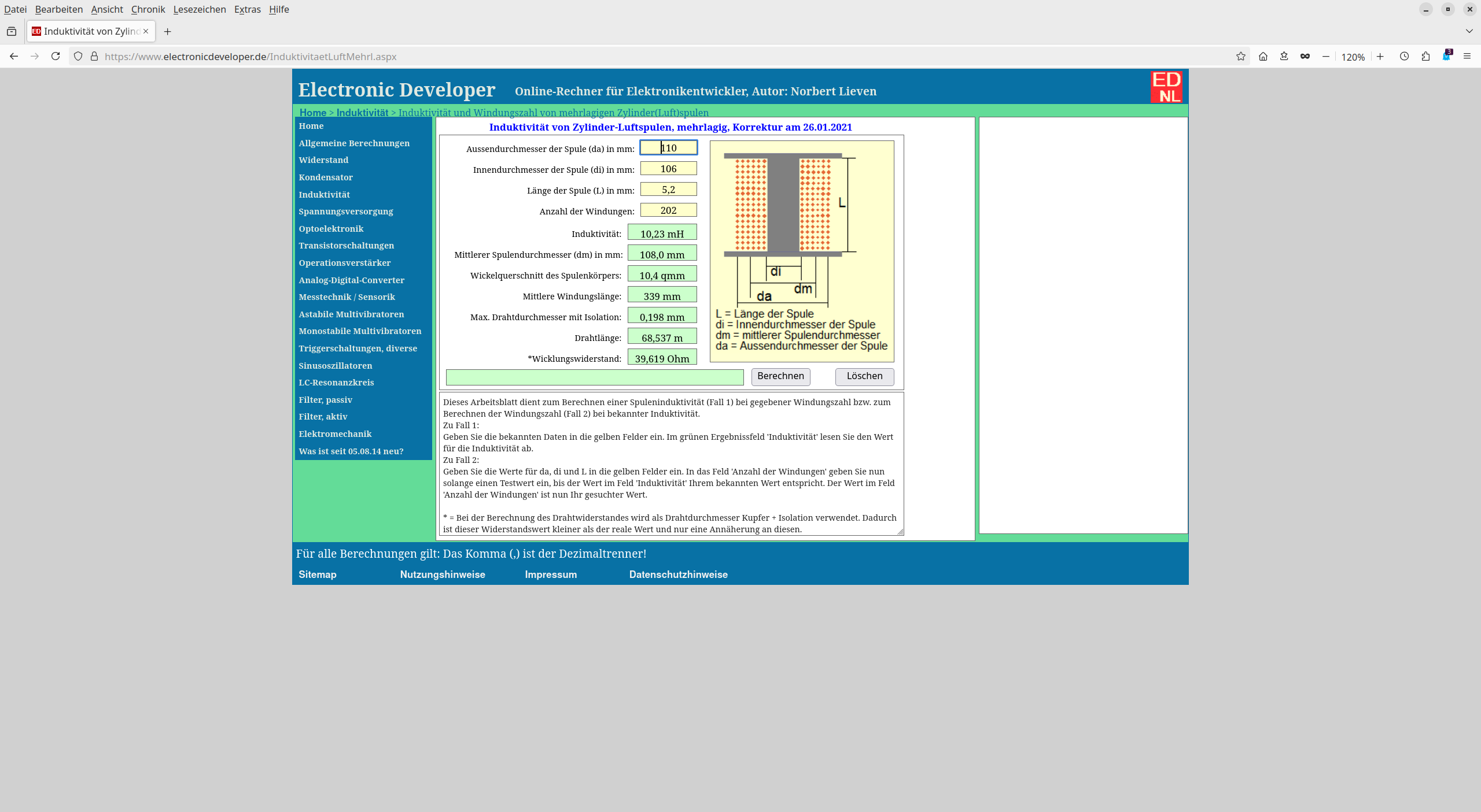

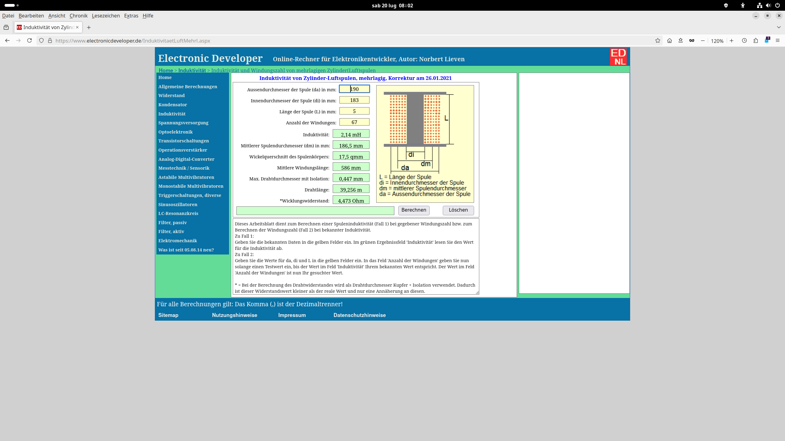

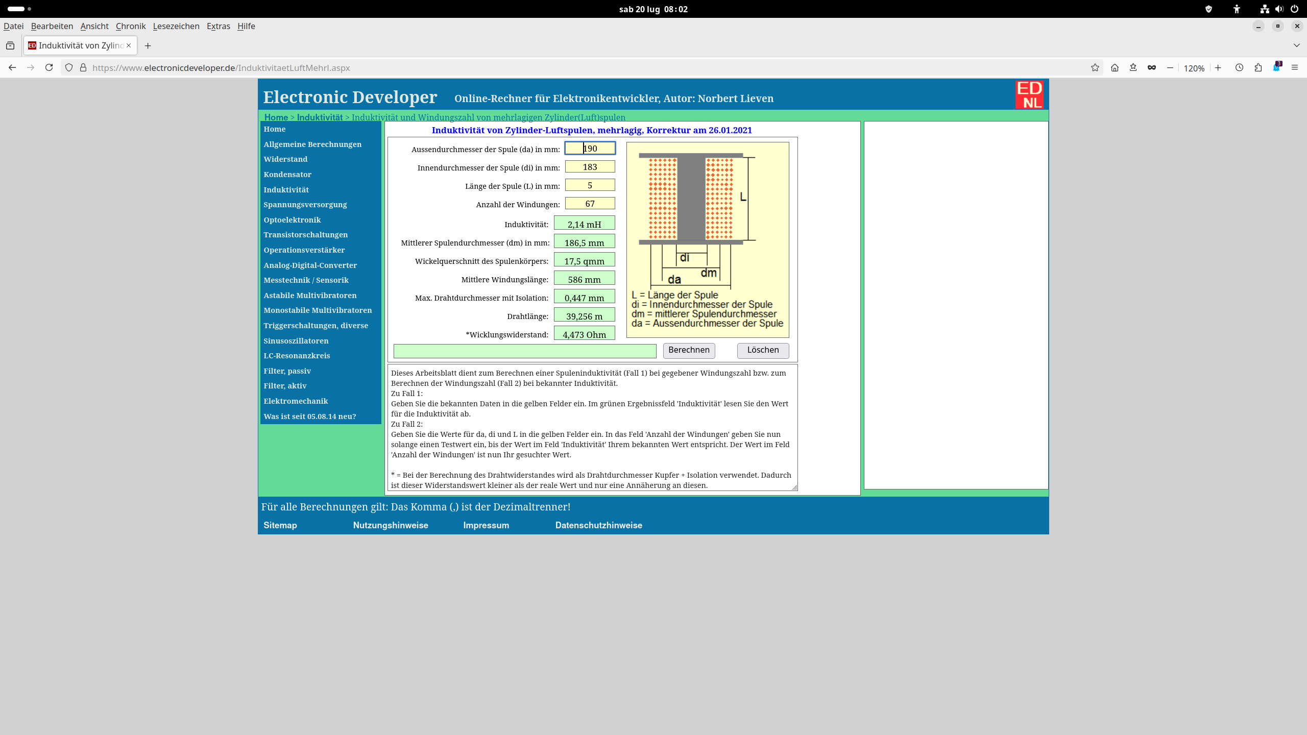

                        The only values I have are the millimeter dimensions of the coil and the values of 4.9 and 39 ohms measured on the cable.
                        The total diameter of the housing is 201.5mm.
                        The diameter of the outer coil shell, measured on the underside, is 113mm. The outer diameter of the inner coil shell is 102.5mm.
                        The total height of the coil shells is 117mm.
                        The radius (small coil shell) inside is 47.5mm.
                        The average winding diameter of the outer coil (TX) is 187mm.
                        The average winding diameter of the inner coil is 107mm.
                        Now my logical thinking tells me that these coils are manufactured by machine and therefore vary only slightly in their electrical values.
                        Example: 4.8 ohms can sometimes become 4.9 ohms. It must also be possible to divide the ohm values between the two partial coils (TX and bucking) and the cable.
                        The coil windings are encased in epoxy resin. The diameter of the windings can therefore hardly be more than +/-5-6 mm at the most.
                        Online calculator: https://www.electronicdeveloper.de/I...LuftMehrl.aspx
                        Fisher 1266 Coil
                        Rx 10-10.4mH / 38.2-39.3 Ohm
                        Tx 2.14-2.2mH / 4.7-4.9 Ohm
                        Values also work in the LT spice simulation.​

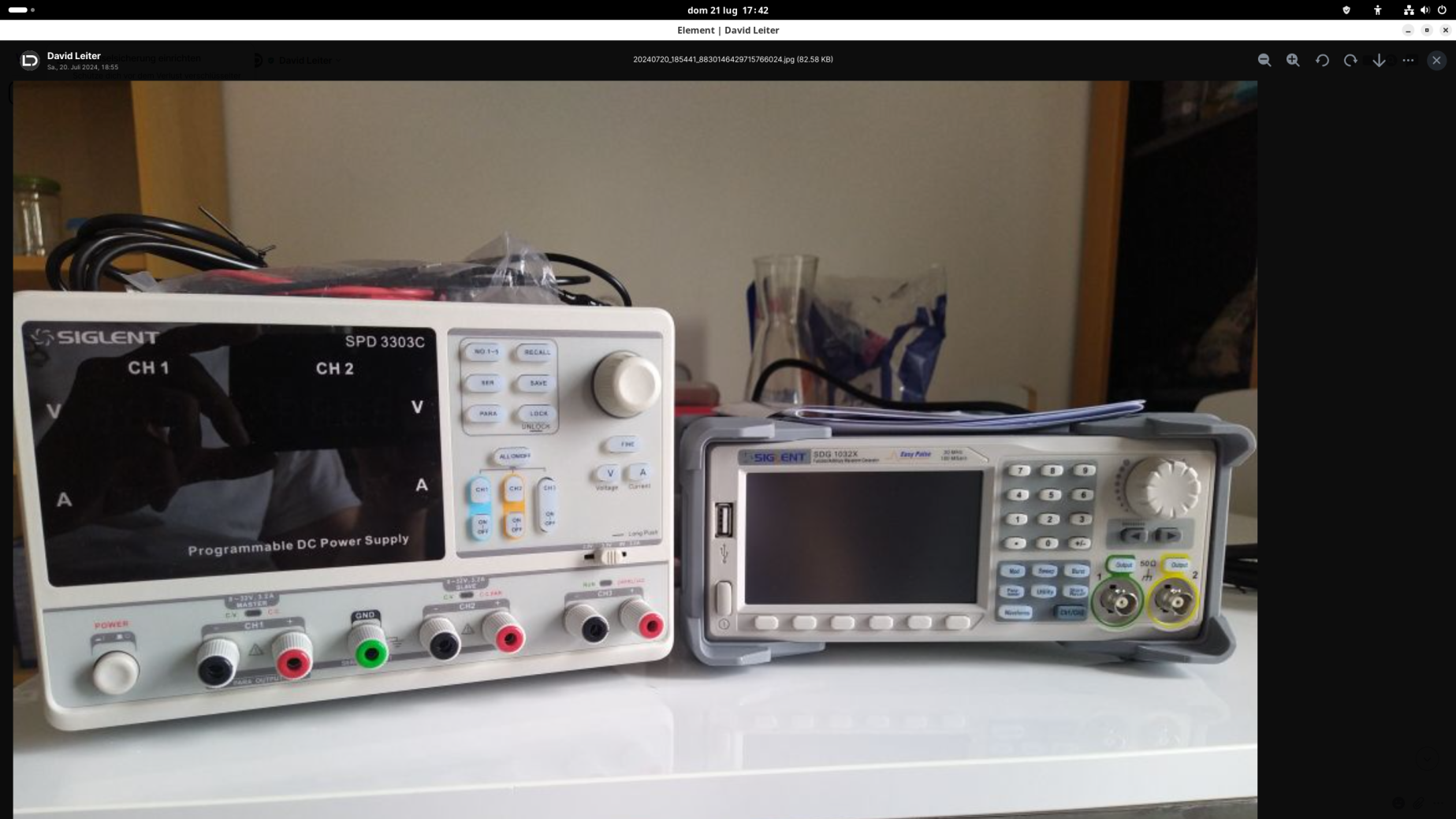

                          i have especial folder in Archive with all coil calculators, all of them i checked. https://drive.google.com/file/d/1JB4...usp=drive_link
                            Thank you.
                            I have now found the very best coil calculator. It's on my table.
                            A present from my son. Well, half of it. We share the machines.
                            And yes, that particular list above, the one with the coil parameters, is OK.
                            My coil has TX 2.2 mh / 4.87 ohms.
                            RX 38.44 ohms. 10.3 mH.
